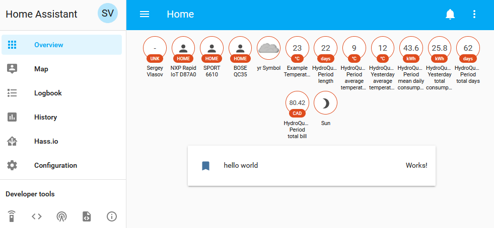

Now I' can see the state of all tracked BLE devices at the assistant Devices page:

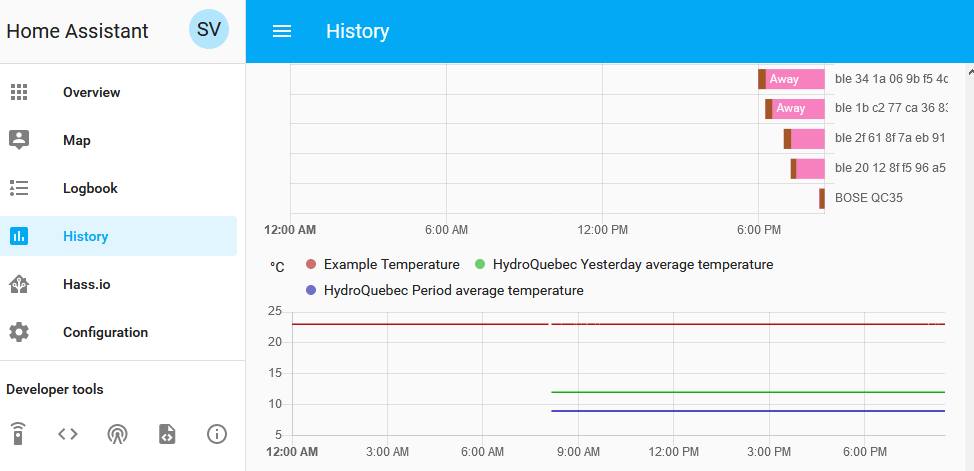

And I can as well see the history of devices and change of their states (Home<->Away)
