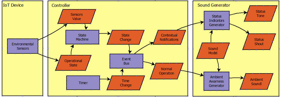

SHOAMM consists from the following key components:
IoT device
IoT device is responsible to capture environmental conditions and communicate sensors readings and its state to the controller.
Controller
Controller is responsible to orchestrate information flows from IoT Device sensors to Sound Generator.
It includes several sub-components:
State Machine
State Machine (digital tween) converts sensor data into state information and communicates state changes.
Event Bus
Event Bus communicates State Machine events to the Sound generator.
Timer
Timer continuously generates events.
Sound Generator
Sound Generator is using Sound Model and input from controller to generate tones and sounds according to CALM principles and related patterns.
Status Tone
Status Tone is a simple indicator generated to notify of change in the state of IoT device.
Status Shout
Status Shout is generated in case of urgent condition detected by IoT device, which requires an immediate attention.
Ambient Sound
Ambient Sound is a background sound, which indicates a normal operation of the IoT device.
In the next blog I'll map components of the reference architecture to target technology components.
    DAB over 7 years ago +2
    Nice plan. I look forward to seeing your implementation. DAB
  • vlasov01
    vlasov01 over 7 years ago in reply to DAB
    I've run into some challenges with Sound Generator. My original plan was to use Tensorflow Magenta model on Raspberry Pi. But I wasn't able to install Magenta so far https://github.com/tensorflow/magenta/issues/1522 . I may need to start looking for a plan B.
