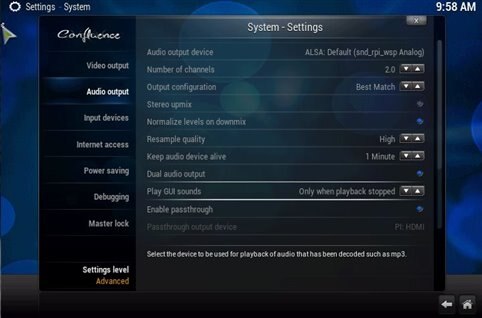

This is the most difficult task for me because as I have slow internet connectivity and I am not sure whether it works or not. After updating I get the sound output from the wolfson pi but with some static noise.
Then again I followed the kernel updater steps and changed the few setting it again stopped working. At this moment I got fully frustrated.
This moment I followed the other method and in RaspBMC setting I enabled setting to use external sound device. Then when I open the audio device setting I found this
(snd_rpi_wsp Analog) in the setting after I enabled this I got sound output to my RaspBMC.
Might be that’s because of the RaspBMC build but I am not sure for this.

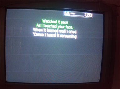

Other than that when I tried playing .kar files it also works.
For playing karaoke you just need to change few setting.
For playing karaoke files you need to enable karaoke support.
Go to SYSTEM-> SETTINGS-> MUSIC-> ENABLE KARAOKE SUPPORT.
You can also edit the font setting that how you want to see the lyrics on the screen.
This is the setting you need to enable on XBMC. But still it is not done.

When I playing .kar karaoke file it is bit lagging. But overall performance is better. Other formats works best.
This is karaoke on my 10 years old TV. image
