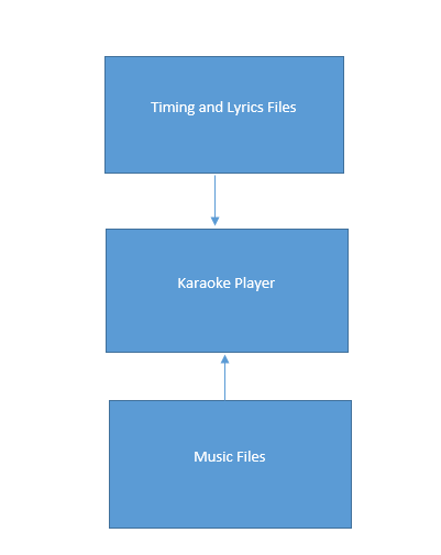

I have made the karaoke player with python pygame.
Following are the steps in it
1)I have installed wheezy Linux on Raspberry Pi, which was already in the NOOBS.
2) For working with Wolfson PI AUDIO CARD, I have used Kernel,modules and scripts given by ragnar.jensen at
Re: Re: Wolfson modified Noobs raspbian zipped img  Cannot unzip new download
after installing it you will need to execute scripts for each devices in home/pi/use_case_scripts
3)This player uses 3 types of file for one song:
                         MP3 File
                         Lyrics File
                         Timing File

6) You need to execute:
arecord|aplay
in separate terminal.
7)To player just go to Kariyoke_machine Folder in Home and execute Karaoke_Player.m
8)Enjoy !!
