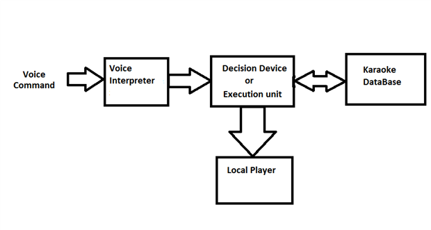

This is the block representation of my idea.
It has totally 4 different blocks or parts.
In todays post I just tell about the installation of the few software which is used in handling these blocks.
Let’s start with database section.
In the whole idea this is the longest part. Otherwise the idea is small.
For the database section I created a php script which helps in storing the karaoke file and provide response to requests.
So for that I created a independent web-server on the Raspberry Pi.

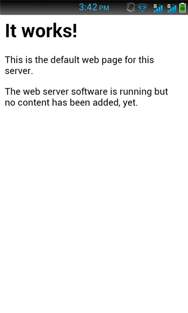

Enter the raspberry pi IP in the browser
You get the response like this.
Edit the index.html file to see whatever you want. The file is located in /var/www/
See what I have made changes to the file and the response I get.

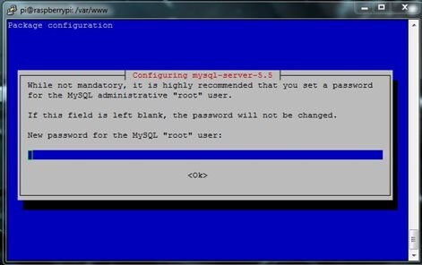

Now the next step is to installing mysql server.
To install mysql server enter the following in terminal
sudo apt-get install mysql-server mysql-client php5-mysql
while in the installation it will ask you to create a password. Enter the password of your own choice.
