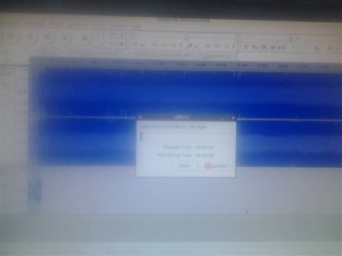

After facing several types of roadblocks and errors finally we succeeded .... Here we designed a complete offline karaoke maker with the superb combination of wolfson card and Raspberry pi that will convert  the given mp3 to karaoke using audacity with music mixer. we used cross compiled audacity here https://drive.google.com/file/d/0BzIaxMH3N5O1Q0dsOC1qY2h1azg/edit?usp=sharing from Ragnar jensen. Finally we have made huge changes that converts the mp3 into karaoke with more special effects.The user can also add their own special effects for more fun and to entertain the audience.
Here we put lot of effort to automate the audacity and we scripted these 3 shell scripts that will automate the audacity progress which will  import ----> Adding Effect---->Export karoake.

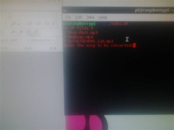

Suku.sh --->> This script acts as a main script that will ask the user to select the song that is previously added into the target folder. The image given below shows that  once the script gets executed it will ask for the option to be entered and it will select the song and finally pass it to the audacity automatically for further process (kindly refer the attachment screenshots for more information).

Make_karaoke.sh--->> This file makes the necessary changes to remove the vocals by applying the chains(predefined  step by step procedure applied by the user)available in the audacity.

After spending plenty hours of time we have found 3 different methods to remove the vocal from the given mp3 file for better output, And it can be downloaded from here
https://drive.google.com/file/d/0B9rdOLp3dLQIa0ZhOVBsOFVSVWc/edit?usp=sharing
effect.sh--->>  This script will give special touch to the karaoke based on the user's taste of music the instrumental effects can be added accordingly, from a specific folder containing various Instrumental effects such as solo drum, piano,etc,.
