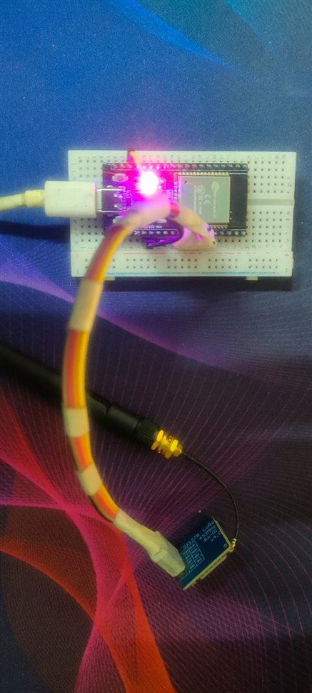

So now my Arduino MKR Wan start sending data and also ESP32 and LoRa: Ra-02 start taking it with just receiving code.
  • Analysis of honey BeeHive
Here I am going to showcase and discuss the software part and the final project. The Code to send the data using loRa(Ra-02) 433MHz.
