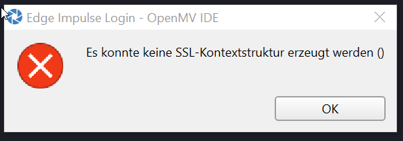

The first one was uploading pictures with the IDE:
But do not worry if you cannot login to the Edge account from the IDE, there is  already a ticket open to get it fixed.
Might just be an outdated version of OpenSSL.
Error Message looks like that, but the good thing is we do not need the feature Sweat smile

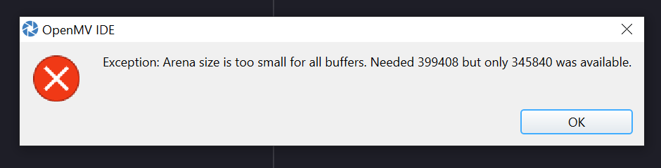

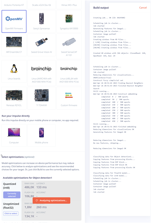

The 2nd issue is about memory:

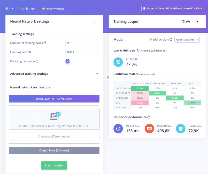

Our screenshots from the trained model, showed before, had a tiny issue which we missed Slight smile We totally forgot about memory:
As it turns out the model needs in peak 2.5MB RAM which we do not have have Face palm We have access to 1MB of RAM.
Within that we should fit the model and also the picture to analyse. So back to teaching the model with lower resolution so we can run it on the Nicla Board.
The result was a tiny bit worse detection rate but no crash on the openMV IDE Thumbsup

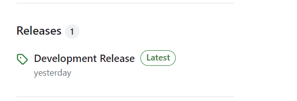

We also forked the openMV IDE via Github to include the trained model and build our own firmware.
And digging around on the Edge implus platform, we would not have to go this extra step, you can directly download the binary file on the website. Drooling face

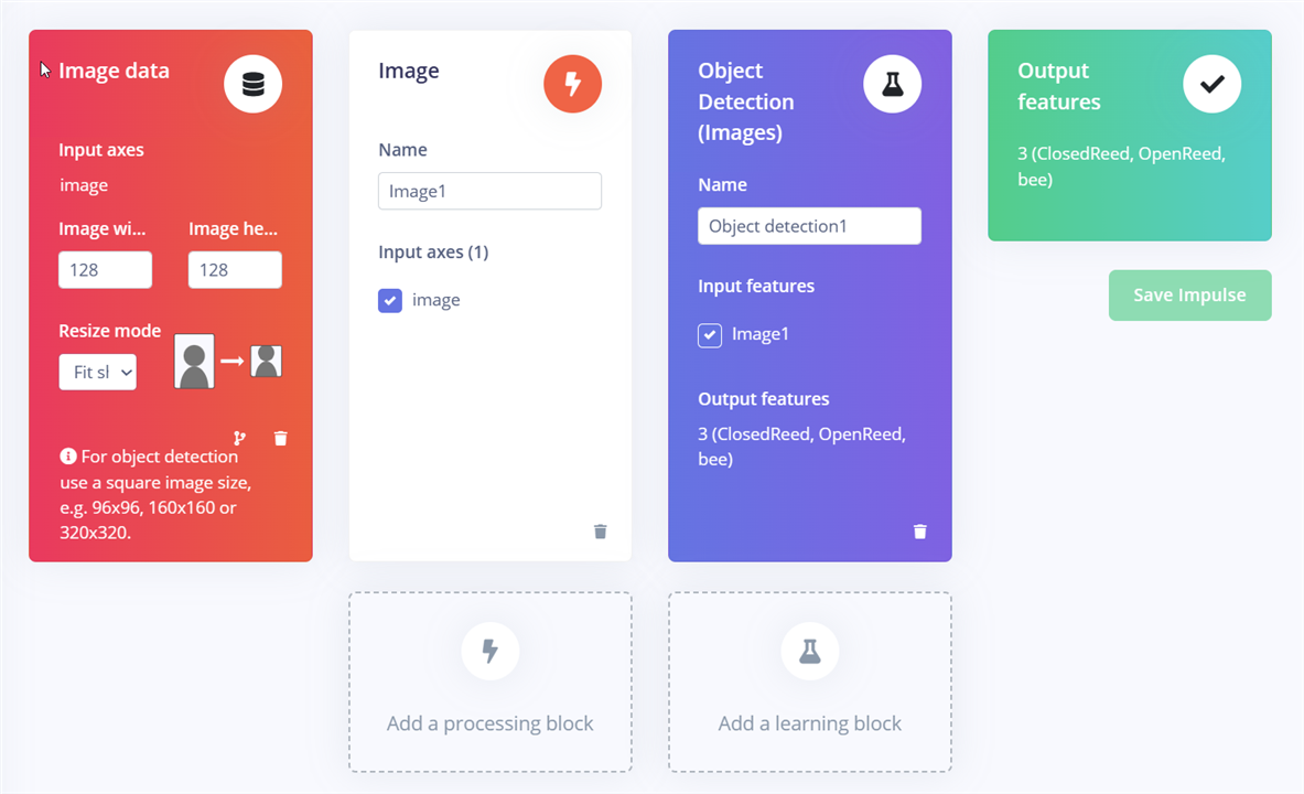

So here is the image data setup:

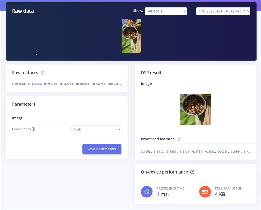

with the RGB color profile:
Feature generated several times:

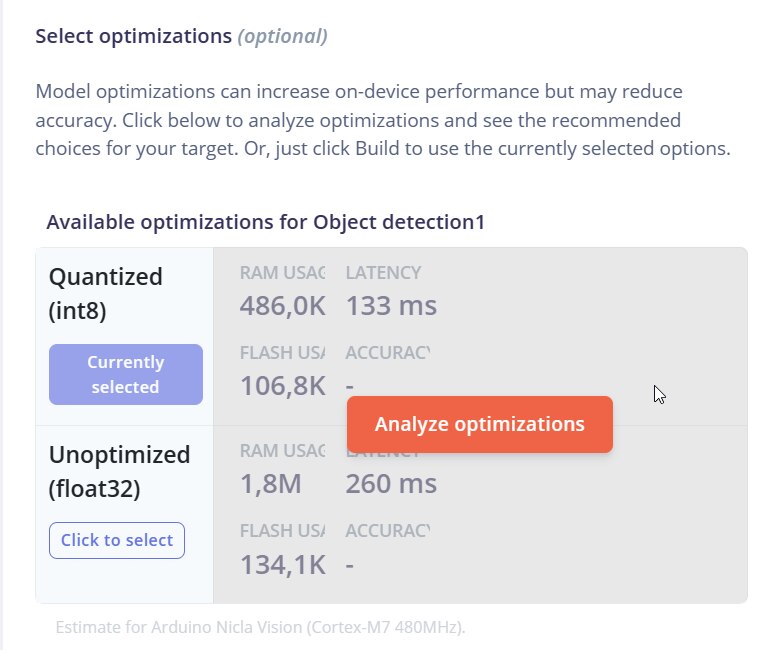

And finally an model that fits with the RAM even during peak RAM needs:
The solution can be optimized which we went for Slight smile:
And then we selected openMV as export:
The export can be found here: in case i am not allowed to share it i will remove it Slight smile
