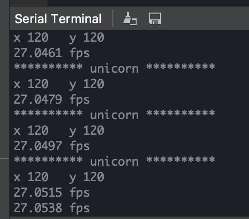

After updating the firmware like that, DO NOT use the ei_image_classification.py python script that was part of the downloaded zip file (still in OpenMV). At least, in my case, it just kept crashing. Instead, I used the tf_object_detection_examply.py that’s in the OpenMV examples list, and changed the line that loads the model to use the model named “trained”. You can find the name of your ML model in the python script that Edge Impulse created, but as far as I can tell it seems to default to “trained”.
labels, net = tf.load_builtin_model("trained")
As they’ve mentioned a few times before in the tutorials, if you haven’t already done this, add these two lines to the script to flip the image to make it look normal when holding the Nicla Sense board with the usb cord under it.
sensor.set_vflip(True) # Flips the image vertically
sensor.set_hmirror(True) # Mirrors the image horizontally
This worked really quite nicely for me, with the minor exception that EVERYTHING is being identified as a unicorn!! UnicornUnicornUnicorn
A world full of unicorns
Does this look like a unicorn to you?
Definitely (maybe?) not a unicorn
Now, it’s entirely possible that I am surrounded by magical unicorns in an overlayed extra dimension that I can’t see, but I have a hunch that I may have missed something important when building the model… I think I read something about needing an extra class for when there’s nothing to identify. Even the example code says this in a comment: “we skip class index 0, as that is the background”.
I think I’ll have to try building a new ML model. Maybe I’ll just focus on rubber duckies. The unicorns I have look too much like ducks :D
