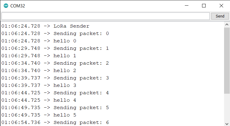

On running the LoRa transmitter & receiver example,
Transmitter code:
#include <SPI.h>
#include <LoRa.h>
int counter = 0;
void setup() {
  Serial.begin(9600);
  while (!Serial);
  Serial.println("LoRa Sender");
  if (!LoRa.begin(868E6)) {
    Serial.println("Starting LoRa failed!");
    while (1);
void loop() {
  Serial.print("Sending packet: ");
  Serial.println(counter);
  // send packet
  LoRa.beginPacket();
  LoRa.print("hello ");
  LoRa.print(counter);
  LoRa.endPacket();
  counter++;
  delay(5000);
 Receiver code:
#include <SPI.h>
#include <LoRa.h>
void setup() {
  Serial.begin(9600);
  while (!Serial);
  Serial.println("LoRa Receiver");
    while (1);
void loop() {
  // try to parse packet
  int packetSize = LoRa.parsePacket();
  if (packetSize) {
    // received a packet
    Serial.print("Received packet '");
    // read packet
    while (LoRa.available()) {
      Serial.print((char)LoRa.read());
    // print RSSI of packet
    Serial.print("' with RSSI ");
    Serial.println(LoRa.packetRssi());
