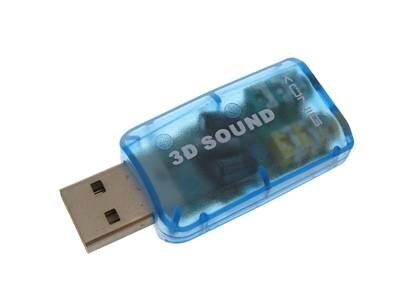

Is time for a new step in Cybernetic Interface development - audio interface configuration.
Because RaspberryPi lacks a microphone input, which I need for my project, I had to add and configure an external USB sound card.
Due to space constraints I picked the smallest I could find,  Konig 3D Sound, based on C-Media CM108 Audio Controller.
It worked from the first try, plugged directly in RPi USB port or in USB Hub.
Configuration and testing steps are listed bellow:

Using mpg321 (mpg123/mplayer/aplay/other) and favourite test sound file, plug headphones or speakers into external soundcard output and check if the sound is correctly played. It did image
pi@cyberpi ~$ mpg321 /home/pi/test.mp3
Ok, with playback working, let's check the recording side.
Plug microphone into USB soundcard input and launch:
pi@cyberpi ~$ arecord -D plughw:0,0 -f cd ./test.wav
Use Ctrl+C to stop recording.
Check the result -> pi@cyberpi ~$ mpg321 test.wav -> success image.
If needed, use "alsamixer -c 0" to adjust sound levels to meet your requirements.
That's it. Now I have both audio playback and recording on Raspberry PI.
