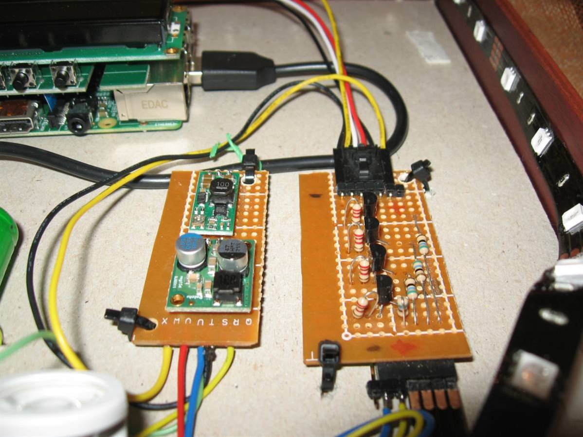

Power board
Power board should be able to supply reliable power to RPi and all peripherals.
RPi, sound card, WiFi dongle and SD Card reader need 5V, power LED and RGB strip need 12V.
For 5V rail I used Pololu 5V, 5A Step-Down Voltage Regulator D24V50F5. May be a little overkill for this application but I like to have some reserve. Besides, keeping a lower load on the converter the drop-out voltage is lower than for higher load, around 1V. If I had used a converter rated for lower current output, 2Amps for example, the load would been higher and drop-out voltage also higher, which is less efficient for a battery powered application.
For 12V rail I choose Pololu Adjustable Boost Regulator 4-25V, set at 12V.

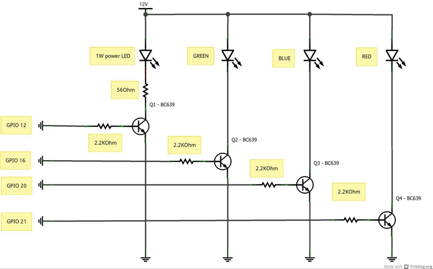

LEDs control board
I build it on a piece of perf board and consist in four BC639 medium power NPN transistors and current limiting resistor for connection to RPi GPIO pins.
RGB LED strip is connected directly to 12V rail and the 1W power LED have a current limiting resistor.
Light intensity for RGB LED strip and power LED is controlled using PWM.
For PWM I used GPIO pins 12, 16, 20 and 21 - BCM notation. To generate PWM on these pins I used RPi.GPIO library.
I tried also RPIO library but so far it is not working on RaspberryPi ver.2
Here you can see power board on the left and LEDs control board on the right.
And the schematic:
