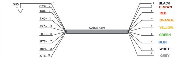

As mentioned in a previous post I am using a USB to RS422 cable(USB-RS422-WE-1800-BTUSB-RS422-WE-1800-BT) to be able to communicate to the Fenner M-Trim controller. The data sheet can be found here: USB-RS422-FTDI
The cable pinout can be seen below:
The TXD-/TXD+ on the cable is connected to the RX-/RX+ on the MTrim and the RX-/RX+ on the cable is connected to the TX-/TX+ on the MTrim. The GND on the cable is connected to the GND on the MTrim. Once connected it works very well. The USB side of the cable has 2 LED's - a red for transmit and a green for receive. So it is very easy to see when signal transmission is happening. With the exception of the price of this cable, I am very pleased with its performance.
