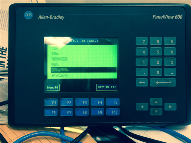

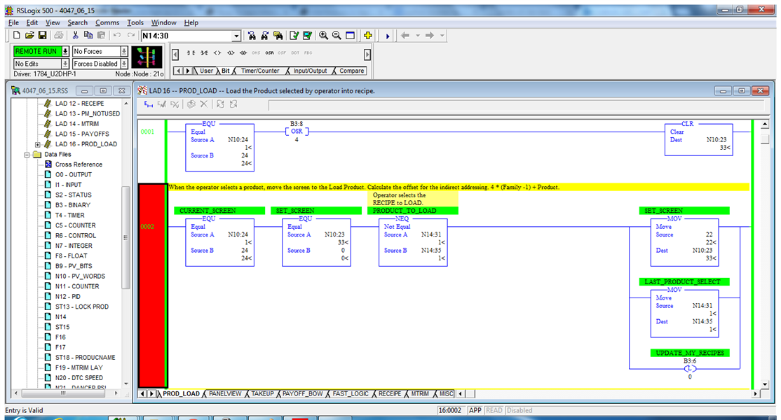

In order to load recipes, the operator will interact through the PanelView display. The operator chooses to load a new recipe by first selecting a recipe 'Family', then selecting the actual product. As can be seen below N10:23 and N10:24 hold the current screen that the operator is on and the next screen to load. When the operator has selected a product to load, bit B3:6/0 is set to signal that a product has been selected. The RPi is reading this bit, along with a couple of others, every 0.2 seconds. When it detects that this bit is True, it reads the product that was selected from the PLC, then reads the recipe file from the SD card on the RPi and selects the appropriate recipe data from the file. The RPi then sends this data to the PLC and when the data transfer is complete will clear B3:6/0.
The operator will select the recipe 'Family' as shown in the below picture. Due to corporate policy I had to distort the choices, but I think you get the point.

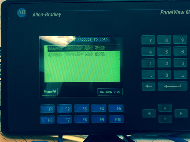

Once the 'Family' is selected, the actual recipe will be selected as shown in the below picture.

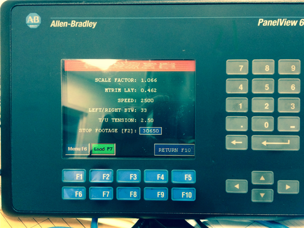

Once the recipe is selected, bit B3:6/0 is set in the PLC.

    This is a project that I am doing at the company I work for. In obtaining permission to post the photos, I was asked to blur the recipe names. The recipe names aren't really important to the project. The important part is more to see that you select the recipe and the RPI can read it, find the recipe file, read the recipe file, and upload to the PLC.

    Nice work Eric! Is there a special reason that the text menus on the screen photos is not shown (it seems a blurred artifact) ?
