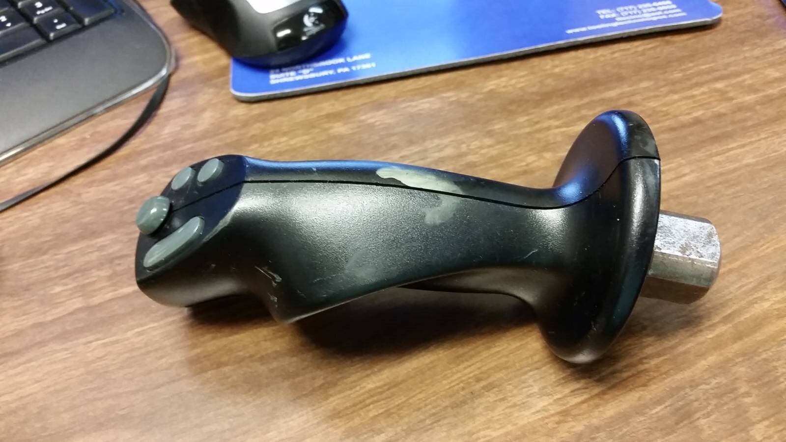

    scrpn17w over 11 years ago
    I did some digging around yesterday and came upon a project I started a few years ago. image
