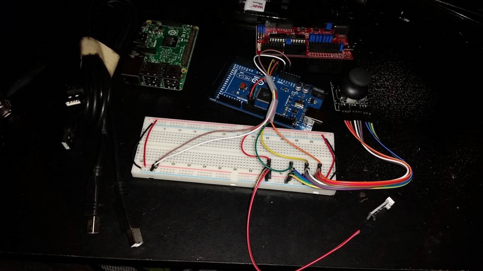

    I went through the box of parts I received and got out most of the main components I'm going to use from it. I'm planning on using the Pi-2 as the central hub of the system, the Wi-Pi for wireless connections, the Chipkit-Pi to replace some of the Arduino modules and the Pi-Face board with relays on it to control high power draw items (oil slick pumps). I also decided to setup a breadboard/Arduino connection with a couple buttons and a thumb stick (variable Analog inputs) to start building up the control panel for the Pi. My plan for this week is to get the couple buttons and thumb stick working as an input to the Pi just so I have the basics down for getting the communication between the boards working. I'll add more buttons and switches later on. For now I'm starting small.

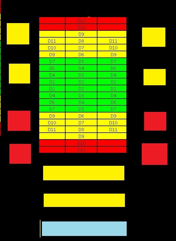

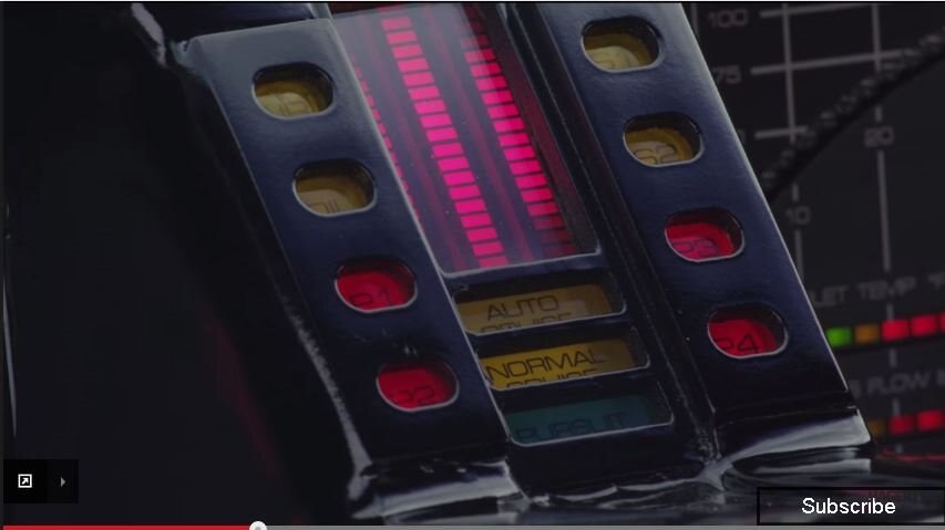

    I did some lay out work for a small section of on of the dash panels. I used this screenshot as a reference for my layout. image
    This was from the video Ilinked to in my original post of the KITT replica. My layout looks like image
    Where the center is what I wanted my visualizer to look like (KITT speaks, the lights flash to his voice). The side squares and bottom rectangles would all be status lights of various systems, though I may replace one of the rectangles with a digital readout that displays when a system has been activated.
    Inside of the "Visualizer" the blocks are all marked with D#. These numbers correspond to digital pins on an Arduino which I will use to control this subsystem. I plan on using an audio signal coming from the Raspberry-Pi as an input for this system, which will be analyzed through a Fourier transform to have the audio levels broken down. The LEDs will illuminate based on the level of the audio signal.
