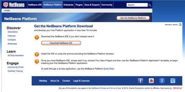

To install a copy of the IDE on your PC it is sufficient to go to the NetBeans IDE platform download page downloading the last available version for yourplatform (Mac, Windows or Linux)
The installation is simple and in most cases the default settings are all what you need.

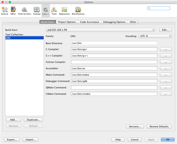

From the settings windows (see the image above) you can customize all the features of the IDE, e.g. the editor behavior, source font and colors, the graphic appearance and so on. From the C/C++ option tab select the GNU compiler (it should be the default, else add it updating the IDE with the Add button on the same window).

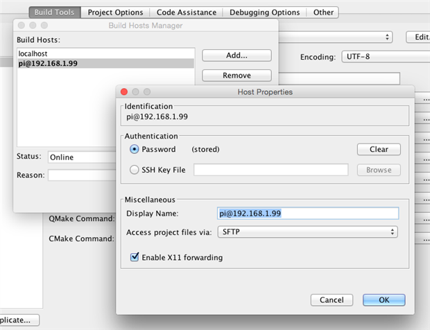

Againfrom the same window you should Edit the host list (by default there is only localhost, the development PC) adding the parameters to connect with the Raspberry pi:
  • Add the user (in this case the default user pi)
  • Add the password and confirm to save it avoiding to repeat it every time the IDE starts connecting to the Raspberry PI
  • Insert the Raspberry PI IP address (better to set a static IP instead of a DHCP assigned to avoid the IP changed the next time you reopen the IDE)
  • Specify the access mode SFTP (that is, FTP protocol over SSH connection)
  • Enable the X11 (the linux graphic server) forwarding
That's all!

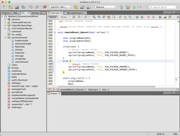

With the IDE set in this way you can start creating a new project and write your code. On the IDE top toolbar there is the connection button to activate the remote connection with the Raspberry PI. To compile remotely from the PC you should be connected. As the device is remotely connected NetBeans gives you the option to edit the application sources locally but when you Build the application the sources are automatically zipped, sent to the remote device (the Raspberry PI), unzipped and compiled. Errors and messages are shown in the Build result window making the debug very simple.
Another very useful feature is the option to open a remote terminal directly from the IDE. In this way, as shown in the following screencast, the development lifecycle included the program running and testing become very simple and efficient with a minimal effort.

    sw.teach.me over 11 years ago in reply to balearicdynamics
    Hi Enrico,
    I finally succeeded, The GNU tool collection came automatically right after setting up the Build Host connection to Raspberry PI.
    Thanks a lot for this great tutorial.
