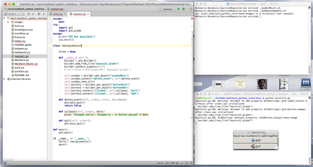

We can comfortable develop our Python applications on the Raspberry PI with only three windows:
  • The PyCharm IDE window
  • A local terminal session
  • A Raspberry PI remote SSH terminal session
The following image shows the PC with the Python develompent settings
