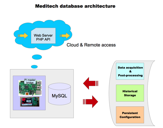

The following scheme shows the central role of the RPI master database in the data collection, storage and distribution.
The MySQL database inside the Meditech architecture represent the main data center. Installed on the same RPI master unit there is also the Apache2 web server and PHP server. The database is also used for store single-record tables with the persistent configuration data of the system.
The data sets that should be available from remote can be accessed through a set of PHP APIs; this strategy permit to access from remote the real time information (for external support and assistance) using any Internet-connected device including smartphones and tablets, PC and laptop with a connected browser.
As all the Meditech units are connected on the same LAN the data exchange is fast as the MySQL server on the RPI master is accessed by the other units directly via SQL queries using SSH tunnels.
