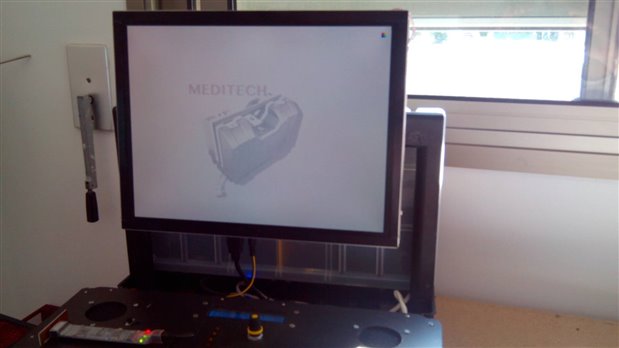

The "glue" keeping all together and distributing the tasks correctly, depending on the user requests is the main controller, a sort of semaphore component created in Python. So what is the better place where this application can reside? on the background. Not running in background but on the background graphic component that is the minimal view shown on the screen while the system is powered-on.
So, the image above shows the just powered-on Meditech face. As the entire system is controlled through the Infrared Controller until the system is not put in maintenance mode and connected with a mouse and keyboard there is no way to enter in a deeper level of the system. And there is no reason.
The actual developing version of the prototype, for obvious reasons does not start automatically on boot but the application version will start directly with the standard interface.

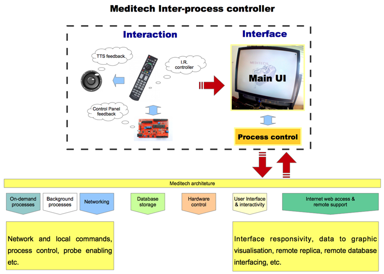

Controlling the system behaviour
At this point there is another important question to be answered: how to manage the Meditech architecture data flow?
As the user interface manager is the nearest task to the user interaction this is also the best candidate to manage the entire data flow and task execution. When Meditech is powered-on this is the process that is started automatically together with the infrared controller appplication. The interaction module send commands and requests directly to the process controller that shows the background main User Interface. At this point the system is ready to manage all the parts from a single asynchronous controller.
Note that the graphic view for every status, informational window, graphic etc. is actuated by independent Python widgets launched and blocked by the process control as well as the activation of the probes. But the other side the background processes are ready to receive the probes information, collect data and store them on the database. As the remote access is to the information is under the user control also the activation of the Internet transmission to the remote server over a dependent MySQL database is managed by the process controller.
The following scheme illustrates how starting from the User Interaction and direct feedback the system works and react to the requests.
Controlling processes with Python in practice

All the other processes launched by the controller start something in the system by launching a bash script or a C++ command. Every process follows a double-data exchange with the controller enabled to decide what is working in a certain moment and what it is not. A typical procedural approach can be the following:
User actionController actionDirection
Enable body temperatureLaunch body temperature widget on-screenRECEIV
Enable the probe activity and start readingSEND
Update the widget dataSEND
Continue updating until the user stop
Every process is launched keeping direct control of its stdin, stdout, stderr while the widget visualisation are graphic objects developed in Python script.
