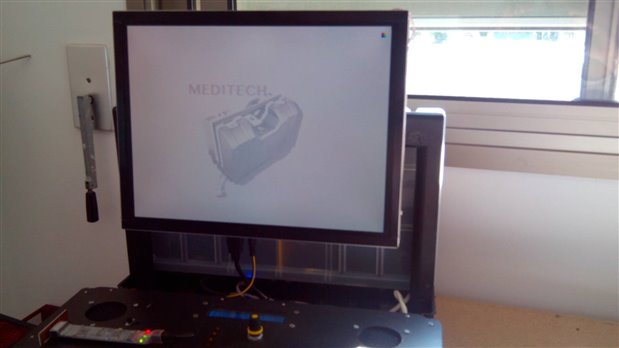

The "glue" keeping all together and distributing the tasks correctly, depending on the user requests is the main controller, a sort of semaphore component created in Python. So what is the better place where this application can reside? on the background. Not running in background but on the background graphic component that is the minimal view shown on the screen while the system is powered-on.
So, the image above shows the just powered-on Meditech face. As the entire system is controlled through the Infrared Controller until the system is not put in maintenance mode and connected with a mouse and keyboard there is no way to enter in a deeper level of the system. And there is no reason.
The actual developing version of the prototype, for obvious reasons does not start automatically on boot but the application version will start directly with the standard interface.

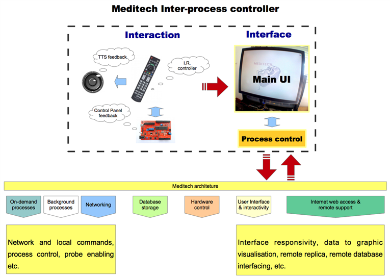

At this point there is another important question to be answered: how to manage the Meditech architecture data flow?
As the user interface manager is the nearest task to the user interaction this is also the best candidate to manage the entire data flow and task execution. When Meditech is powered-on this is the process that is started automatically together with the infrared controller appplication. The interaction module send commands and requests directly to the process controller that shows the background main User Interface. At this point the system is ready to manage all the parts from a single asynchronous controller.
Note that the graphic view for every status, informational window, graphic etc. is actuated by independent Python widgets launched and blocked by the process control as well as the activation of the probes. But the other side the background processes are ready to receive the probes information, collect data and store them on the database. As the remote access is to the information is under the user control also the activation of the Internet transmission to the remote server over a dependent MySQL database is managed by the process controller.
The following scheme illustrates how starting from the User Interaction and direct feedback the system works and react to the requests.
Controlling processes with Python in practice
As occur in almost any language al sin Python it is possible to launch external tasks, i.e. bash scripts, programs or other Python scripts. The problem arise when the Python process control application should act as a semaphore (also intended in the traditional IT way). The choice of Python - should be remarked - instead of something more low-level depends on the graphic performances of the language; in this way it is possible to integrate both the main UI visualisation and the process control saving one more task running inside the RPI master device.
The approach in Python is almost simple: there are three different instructions enabled to launch external programs. The first (and probably more immediate) approach is the use of the os.system() call to deal for another process with the operating system; no matter how this command is done, C++ or any other compiled language, java or bash. So, for example:
import os
print(os.popen('command').readline())
x = _
print(x)
This is the first method to be avoided, due the complexity managing the return values. The other potential issue is that with os.system() call Python pass the control of the entire process - that we want to control - to the operating system.
What has demonstrated the right approach instead is the use of the subprocess call. Just like the Python multiprocessing can do managing internal multi-threading, in a similar way subprocess can spawn different processes giving more control to the calling application, in a simpler way. So it is possible - that is our case - manage the following architecture:
  1. Start the main UI + process control
  2. Start the IR controller that send back to the controller the user requests, commands etc.
  3. At this point the process is full operational
All the other processes launched by the controller start something in the system by launching a bash script or a C++ command. Every process follows a double-data exchange with the controller enabled to decide what is working in a certain moment and what it is not. A typical procedural approach can be the following:
User actionController actionDirection
Enable body temperatureLaunch body temperature widget on-screenRECEIV
Enable the probe activity and start readingSEND
Update the widget dataSEND
Continue updating until the user stop
Every process is launched keeping direct control of its stdin, stdout, stderr while the widget visualisation are graphic objects developed in Python script.
For subprocess details in Python, this link is a good starting point.
For the full explanation of the subprocess, this is the Python link manual
