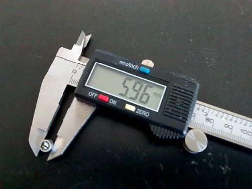

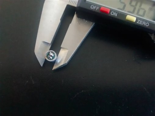

The microphonic stethoscope replaces the standard earpieces with a small condenser microphone as shown in the images below. Here it was used a common commercial device of 5mm diameter. The microphone should fit in about 20 cm of the stethoscope head. This gives the better sound than put the microphone too near to the stethoscope head. In-line with the microphone there is the cable that is plugged in the audio card. Using a good quality cable with copper shield (leaving it unconnected) I got a good quality/noise ratio. The length of the audio cable is about 2 meters.
The following images shows the microphone in detail

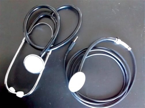

The images below shows the complete probe compared with the traditional one (one hearth, two devices image )

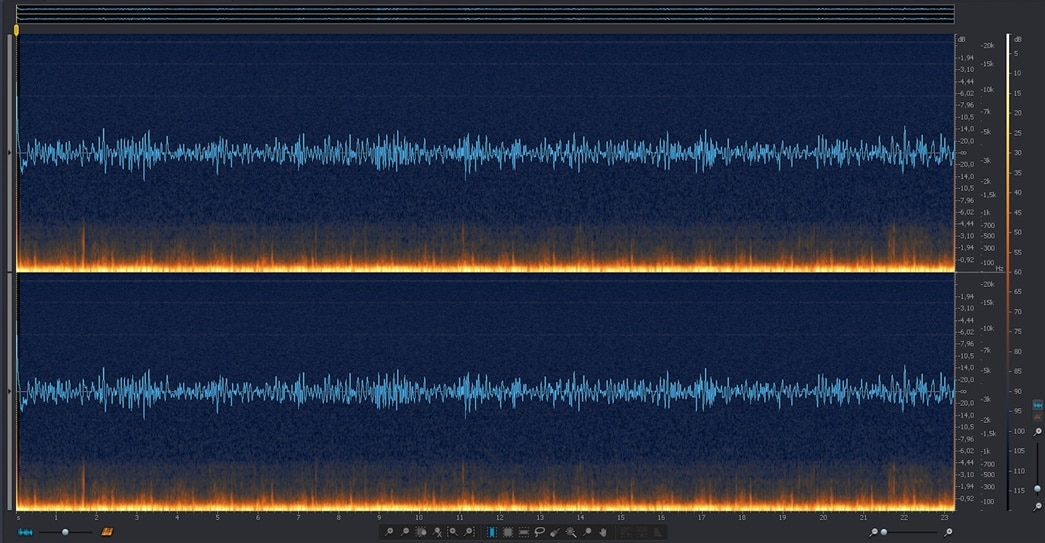

To hear the test.wav file you should use - if from a PC - a couple of headphones reporting good bass sounds else it is very low or impossible to hear. Also put the volume to the max level. The following image shows how the acquired sound curve appears:

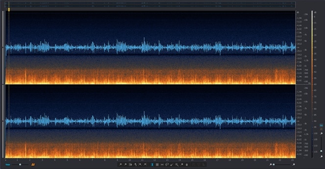

The original sound has been processed (on a fast Mac laptop) using the iZotope software. The following images shows the selective equalisation settings (the noise and unwanted frequencies has been almost completely removed) and the obtained wav file that can be found in attach to this post (the test-processed file)
The definitive approach - that will be discussed in a further article - for the automated processing of the microphonic stethoscope will be done on the dedicated Raspberry PI hosting the sound card. The audio curve optimisation and processing is done with a headless python interface (the real time data are sent to the master device that store them, display etc.) using the snack library that demonstrated to be the open source most reliable and precise project in this field.

    Yes, I have. But the selection of the audio curve and the focus on the specific ranges of frequencies is not experimental. Luckily there is a lot of literature about. I am also trying to reduce a very long (near to a short book) document on the theory of sound auscultation keeping only the technical part interesting to the probe. You should know that there are many examples and recorded sounds of internal body used to teach to medicine students what they should expect with a stethoscope.
    By a certain point of view noise is almost far from the frequencies range that are interesting in terms of diagnostics, and this is a good point. Then the manual application of the selective equalisation like in the images over recorded sounds is just to find the better ranges depending on the response of this specific construction mechanism. The automated algorithm is implemented in the Linux machine using the APIs of the snack library, a very powerful (yet a bit outdated) library developed by the center for speech analysis of Stocholm, famous for their studies and publications over this branch of the sound analysis. They are something similar to the IRRCAM center in Paris for the studies on acoustic of musical instruments.
