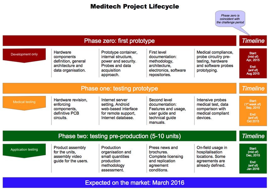

The Meditech project is closing his first part. Starting from this post will follow a series of reminders and informative documentation to focus the point on what is the state-of-the-art project at the date and what is planned for the next two steps, further deadlines etc. The Meditech development lifecycle, from the initial concept up to the product available on the market will pass through three phases; the scheme below is a short reminder of what should be expected:
Accordingly with the scheme above as the most complex and longer step was the phase 0 (started from scratch). The ending of this first part if far away to the end of the entire project that requires again some months of work. At the actual date, there are already the availability (written agreement) with a public hospital in Nigeria, Nanoro (Burkina Fasu) and some other places I am discussing with.
