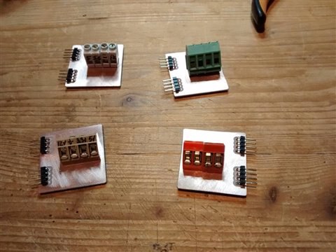

As mentioned before in this first experimental device Medtiech will be powered by an external ATX source providing 3.3V, 5V and 12V distributed with a simple set of power replication units as shown in the images below: the first shows the ATX connected to the main logic power supply switch while the second shows the simple circuit of the power replicators distributed along the center of the box to reach easily the devices..
TODO: Analyse in-depth alternative powering options. As the high voltage power supply is external to the device this solution can be acceptable but in big mobility conditions a battery operated Meditech system should be preferred. A detail that should be considered instead is the power consumption of the entire system - also after a further power usage optimisation. The Raspberry PI units tend to consume at least 2mA/h each one or more, depending on the extra boards attached. Another factor if the operating environment: in extremely hot conditions in conjunction with high humidity percentage the batteries are not a reliable solution if used as the main power source of the system.

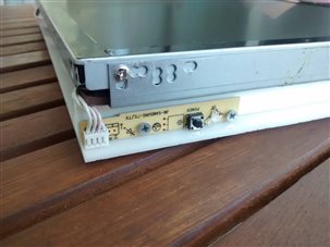

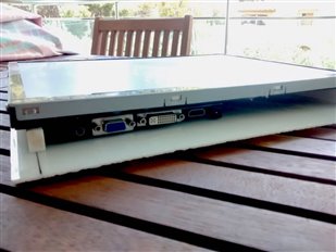

The LCD display has beed adapted to shown the lowest possible profile and the electronic parts has been reassembled with flexible lightweight acrylic plastic components and super-compact micro foam to reduce as much as possible the weight of the unit. The following image shows the final aspect of the 15 inches display that actually weights about 1 Kg less than original.
TODO: A smaller device (e.g. 7 inches) may fit in the Meditech box; this aspect has to be evaluated at the end of the project to give more portability to the entire system without penalising the shown information.
The images below shows some details of the assembled display as in the actual experimental version.

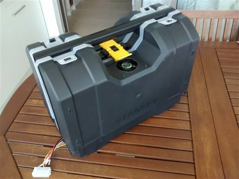

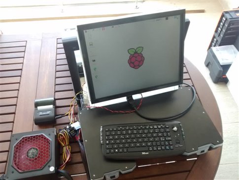

The following image shows the assembled Meditech box as it appears when is close for transportation and open ready to be used. Not that an extra-12Vplug is provided (to the left of the second image) to power the printer. This device can wok with or without connected power as it has its own internal battery accessed via Bluetooth wireless connection.

The center of the box, including the HD (1Tb 5 inches, will be replaced by a 2.5 SSD HD, 180 Gb) and the network hub together with the power units. Note that the cables - especially the LAN connections - will be replaced by shorter ones to reduce the wires occupation.
The image above shows the internal of the devices container. It hosts the service PI (with GPS, Accelerometer, Bluetooth for printing and other support features) on the center, the main PI (with database, collector features, WiFi bridge and data organisation and remote feeding, real time clock) to the right side. The left side hosts the Pi dedicated to the audio acquisition and the analog / digital readings through the Bitscope.
Note that to the bottom right side there is a mechanic switch to detect when the box section opening. This information and other related to the health status of the system (i.e. the internal temperature, the fan speed etc.) are controlled by the ChipKit board (right side) sending critical conditions and changes on the system status to the main PI governing the entire architecture. In response to the sensors feeds the main PI can show alarms and warning pop-up windows with high priority, stop some functionalities or shutdown the entire system.

    Hi Andy, thank you. As a matter of fact some posts ago there was a critics about the usage of the ATX power supply as this will be medical appliance and this kind of switched power supplies may not be…
    balearicdynamics over 10 years ago in reply to Workshopshed
    I see, Andy. This is a sort of fixed point. Then there is also the solar cells question and some other details that will make the powering in some places a bit tricky. So I kept this problem away until the first great step is finished.

    Workshopshed over 10 years ago in reply to balearicdynamics
    For the Enchanted Cottage I worked out the power requirements partly by reading the data sheets and getting the worst case and partly by measuring with a multimeter. As Lucie mentions, you need to have a supply that can handle the peak rating as well as using the average rating values to work out your capacity.

    Former Member over 10 years ago in reply to balearicdynamics
    good reasoning image  even if you were an expert on power units, you still need to know the final power requirements.
    Once you do get to the stage of looking at batteries, some ideas would be those premade for electric wheelchairs, bikes and scooters. Those are designed to provide a relatively high power for a long time and with their intended applications being turning motors under heavy load on and off can provide high "burst" currents.
    From the battery to the devices, some premade switchin regulators from ebay maybe?
    Always good suggestions, Andy ! image
    As you know I am not an expert of battery power units image  and this is the reason I plan to calculate the battery at the final stage of the prototype. This idea of the ATX Power supply by battery sounds good; the link you sent is really a bit expensive but it is a good inspiring matter so it has been saved.
    When the device is full working it is the time to see the real power needed. For example the 5 inches 1Tb HDD in this moment change the energy balance while I am providing a 120 or 250 Gb SSD. And this is not the only thing.
    Don't forget that there is also the solar cells options for powering that needs absolutely a battery at least to gran continuous power. so after the first box has been closed ... I should be time to reopen it.
