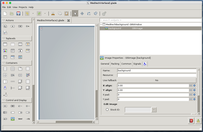

Separating the design from the code
The solution to make the things easier is to operate a separation between the User Interface design and the code. To reach this goal we should adopt a technique very similar to the Android applications, keeping apart the  objects design in XML format  from the PyGTK Python code.
The Meditech Python controller when start shows the main Meditech logo on the screen while managing the inter-process communication. To reach this result  the background image has been created:
Then a special window has been defined in a separate XML file: the MeditechInterface2.glade as shown below
<?xml version="1.0" encoding="UTF-8"?>
<interface>
  <!-- interface-requires gtk+ 3.0 -->
  <object class="GtkWindow" id="MeditechBackground">
    <property name="visible">True</property>
    <property name="sensitive">False</property>
    <property name="can_focus">False</property>
    <property name="halign">center</property>
    <property name="valign">center</property>
    <property name="title" translatable="yes">Meditech 1.0Beta</property>
    <property name="resizable">False</property>
    <property name="modal">True</property>
    <property name="window_position">center-on-parent</property>
    <property name="default_width">1024</property>
    <property name="default_height">1080</property>
    <property name="hide_titlebar_when_maximized">True</property>
    <property name="type_hint">desktop</property>
    <property name="skip_taskbar_hint">True</property>
    <property name="skip_pager_hint">True</property>
    <property name="accept_focus">False</property>
    <property name="focus_on_map">False</property>
    <property name="decorated">False</property>
    <property name="deletable">False</property>
    <property name="gravity">center</property>
    <property name="has_resize_grip">False</property>
    <property name="mnemonics_visible">False</property>
    <property name="focus_visible">False</property>
    <child>
      <object class="GtkImage" id="background">
        <property name="width_request">1024</property>
        <property name="height_request">768</property>
        <property name="xalign">0</property>
        <property name="yalign">0</property>
        <property name="pixbuf">images/Meditech-1024.jpg</property>
      </object>
    </child>
  </object>
</interface>
This is a window where many parameters are  different than the default: there are no decorations, the window is not resizable, the image is centered and both window and image are expanded over the entire screen and more. Designing the UI apart has created a dramatic simplification in the Python code, where the entire UI definition is reduced to a line of code as shown below.
import sys
try:
    import pygtk
    pygtk.require("2.0")
except:
    pass
try:
    import gtk
    import gtk.glade
except:
    print("GTK Not Availible")
    sys.exit(1)
class MeditechMain:
    wTree = None
    def __init__( self ):
        #  ============================ XML with the UI desgn definition
        builder = gtk.Builder()
        builder.add_from_file("MeditechInterface2.glade")
        builder.connect_signals(self)
        self.window = builder.get_object("MeditechBackground")
        self.window.fullscreen()
        self.window.maximize()
        self.window.set_keep_below(True)
        self.window.set_deletable(False)
        # self.window.show_all()
        # self.image = builder.get_object("Background")
        # self.image.show()
def main():
    gtk.main()
if __name__ == "__main__":
    mainClass = MeditechMain()
    main()
What makes the difference is the call add_from_file("MeditechInterface2.glade") incorporating the XML file. Obviously the PyGTK APIs remain available and can be used in the program to make changes and adaptions to the initial UI.
Making the design simple
It is almost intuitive that it is not simple to define the UI components in  XML. It is also obvious that this separation between design and code has also another great advantage: we can retouch and adjust some design issues without changing the code.
The reason that the UI design XML file has the glade extension derives from the name of the graphic IDE we are using, just to create the design. Again this strategy is a remembrance of the Android UI design.
The Glade IDE makes available all the GTK components to design the UI components seeing them as they appear at runtime; then generates the glade XML file when the design is saved to be used in the PyGTK Python application. Details on the installation and usage of the Glade IDE can be found at glade.gnome.org
