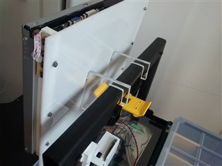

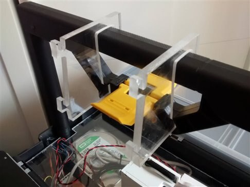

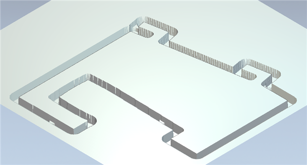

As the 15 inches monitor is carried externally and needs to be set simply and fast to the Meditech box, the top handle has been used designing a couple of rocust and removable parts that - when not in use - can fit in the accessories and components side of the box. The image below shows the 3D milling simulation of the base component; the two ones are identical.
The support can be reviewed with a joint to change the monitor orientation (the right side in the image above) with a fixing screw; this enhancement will be done in the next prototype. The monitor side has a fixed orientation of about 20 Deg for a comfortable viewing while working.
The two images above shows the finished support and the support fit in the box handle. The material used is transparent acrylic 8 mm thick.
The next images shows the Meditech monitor in its definitive position.
