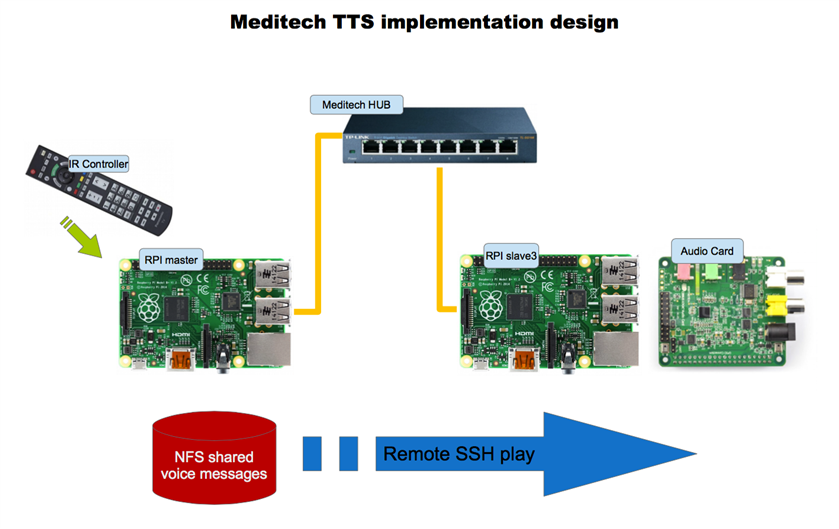

Meditech will be used in many different environments and not always the visual information provided on the screen maybe useful. Receiving helpful audio hints and suggestions on-the-go is a good solution; when the user should activate a probe, start or stop the data acquisition nearby the patient it is very useful to control the entire system with a simple infrared controller but maybe not sufficient. This is the reason that to improve the system usability the TTS (Test-To-Speech) support has been added to enforce the user interaction and system feedback.
The introduction of this feature in the Meditech system has involved two devices: RPI master and RPI slave3 hosting the Cirrus Logic Audio Card.
One of the biggest issues is that as the audio card uses its own custom distribution of the raspian linux with a real-time kernel. Unfortunately it does not support the standard apt-get update and apt-get upgrade features: In few words, the raspian version of the RPI slave 3 should never be updated and there are very few packages that can be installed on this version. In fact the audio card performances are very good and are used for the microphonic stethoscope probe so it is not the worth to replace this hardware with a more flexible one penalising the quality.
Last but not least, the text strings are managed by the controller application installed on the RPI master device.
How it works
The scheme below shows the implementation architecture of the TTS feature in the Meditech device.
The synthesized strings can be disabled with the mute button on the controller. When the synthesis is active when the user press a command on the controller the Meditech speakers says a short contextual sentence. The video below shows the interaction effect.

Also in this case there is a call to the SSH_COMMAND that is a bash script as shown below.
#!/bin/bash
# Play a message remotely
ssh 192.168.5.4 "/home/pi/play_message.sh $1"
Here is the difference. In this case the audio - that is stored on the RPI master linux device, should be played on a different IP address, that is the RPI slave3 linux device hosting the Cirrus Logic Audio Card. To reach this behavior some linux actions were needed:
  • The RPI master storage folder ~/tts_audio_messages has been exported, i.e. shared via linux NFS
  • On the RPI slave3 the same empty folder has been created, then has been mounted remotely. The result is that in the mounted folder there are the same files for playing
  • On the RPI slave3 the bash command play_message.sh has been created (see the description below)
When the spawned (child) process is launched by the controller program on the RPI master what really happens is that the bash script command play_message.sh is executed on the RPI slave3. The only parameter passed is - again image - the message ID. The remote bash command plays the audio file without consuming resources of the RPI master that gain immediately the control of the main program after launching the command.
