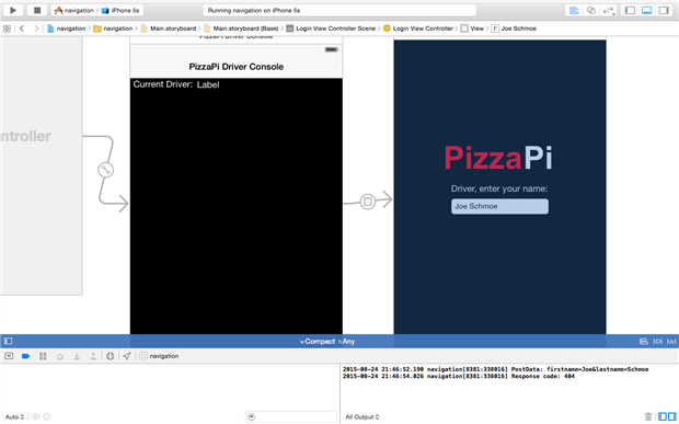

Right, so that's a headache but let's take a look at that screenshot. This is the only part of the whole project that is being coded in OS X, the rest has been coded in Arch Linux/Raspbian. What you see is XCode, Apple's programming IDE. I've tried to use it in the past for other languages but I've always hated its clunkiness but when it comes to iOS development, it really does shine.
You can see the basic layout of the app. There is a login screen that asks for the driver's name. The driver enters his/her name and then the code takes that name, parses it and sends it to the web server for verification and feedback. I'm using this tutorial: https://twitter.com/dave_on_Cape/status/574734739472584704 as my guide and modifying it as I go. You can see in the bottom windows that it's actually tried to run the code that connects to the server, but I haven't finished writing it so of course it sends a response of "404", meaning the verification script (a PHP file that has yet to be written) was not found.

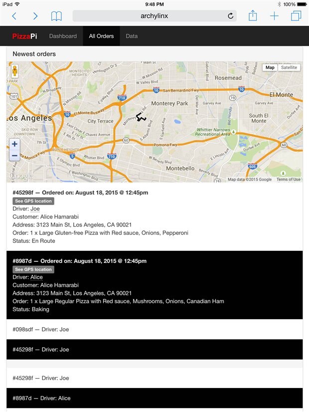

Here's what the layout looks like on an iPad. For the pizza delivery management side I am designing the web interface to be accessible via a tablet. I've noticed that lots of restaurants make use of tablets. It seems a lot easier to use that than a clunky laptop. Anyway, you can see a little black squiggly line on the map. That's some dummy GPS data that I used to test overlaying GPS coordinates onto a Google map. It's not that difficult to do, all you need to use is GeoJSON. There is actually a nifty website (geojson.io) that will format your data for you so you don't really have to learn how to do the formatting yourself.
