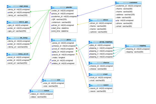

Here is a screenshot of how the database is setup. I use relational database theory and link all the tables together to ensure consistency throughout the backend.
Hopefully the layout is easy to understand. I plan to collect sensor data from individual orders as well as delivery time. This information will later be available for the pizza store to use to improve future orders. There are tables that deal with the pizza itself, such as the kind of sauce, crust, or toppings that a customer might want. The latter tables all link into the main pizza table and then most everything else links into the order table, known as "piorder".
