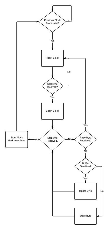

I had mentioned in a previous post that the chip kit pi has some issues that make it different that an Atmel ATMega (Arduino).
The Wire library for arduino allows you to send and receive multiple bytes of data between one stop and start sequence.
However, the ChipKit Pi (Pic 32) has an issue doing this.
Because I am sending commands to the ControlSwitch from the RPFS via I2C, I need to keep command intact.  The commands consist of a controlbyte, a checkbyte, and other data up to 10 bytes.  I worry about missing a byte or getting out of sequence.  By using the wire library I though the built in I2C protocol would be suffice.  Alas, I can only send 1 byte at time.  This means that if I sent the ChipKit Pi 10 bytes, the OnReceive event handler will be called 10 times.  So I have to keep "track" of what is going on in order to completely process a command.  That is, there needs to be persistence between the event handler calls to keep track of the current status of a command to ensure all information is received and valid before doing what the command tells it to do.
So I had to get creative and created a block algorithm for this.  I used the block algorithm for all I2c communications except for the Magnetometer.
A high level general description is that a specific byte is sent that represents a block start.  Another specific byte is then sent as a stop byte.  The block algorithm does not allow repeated starts. That is that once a block is started, it must be specifically ended.  If another start byte is sent before a stop byte, the start byte is counted as data in the block.
The down side to this is that the stopbyte can never be used for data.  That is 1 value out of 256 values so I decided that is ok.  Actually there is another byte that cannot be used either, the resetbyte.
This is sent to reset the block status and let the receiver know a brand new block is coming in.  If the receiver is in the middle of receiving a block, that block is reset.
The resetbyte cannot be used as data either.  So 2 values out of 256 cannot be used.
So A block of data:
[StartByte] [data1..10] [StopByte]
Up to 10 bytes can be sent at a time.  The protocol is set so that way only 1 complete block can be had at one time.  That is, if the receiver has not processed the completed block, a new block cannot be sent.  To ensure this does not create a lock, the sender sends a reset block every time before sending a new block.
A quick flow chart of the block algorithm.

When a block is completed, you can see a variable on line 41 that is set, blockCompleted = true.
In  the main loop of the code, you check this variable routinely and if it toggles to true, then you know you have a new block of data to process.
The ProcessBlock function in the whole code takes the data portion of the block and parses it out.  The first byte of the data portion is usually the "register" I wish to read or write to.  The important thing is that after a block is processed, that the variable blockBlock is set back to false so the event handler can resume getting a new block.  You can see on line 18 above if this variable is set to true, the protocol will start skipping bytes.

    Whether or not the I2C allows for multi byte sends would require research on the specific protocol.  Regardless, the protocol is needed for any project that needs to have a chunk of data sent over.
    Protocols exist for serial communications for this very reason.  You must have a way to send chunks of data, and validate those chunks.  That is the purpose of this code and it would be worthwhile to port over to any system using I2C that needs to send complex  or compound data.  The main purpose of the library is for maintainability reasons.  Right now I have two copies of the code on 2 different devices and I would rather just have 1 copy that is used by both devices.
    In the case of a stream concept, like for IC to IC, it probably is not needed and the overhead would be too much.  But for my purpose it was required!
