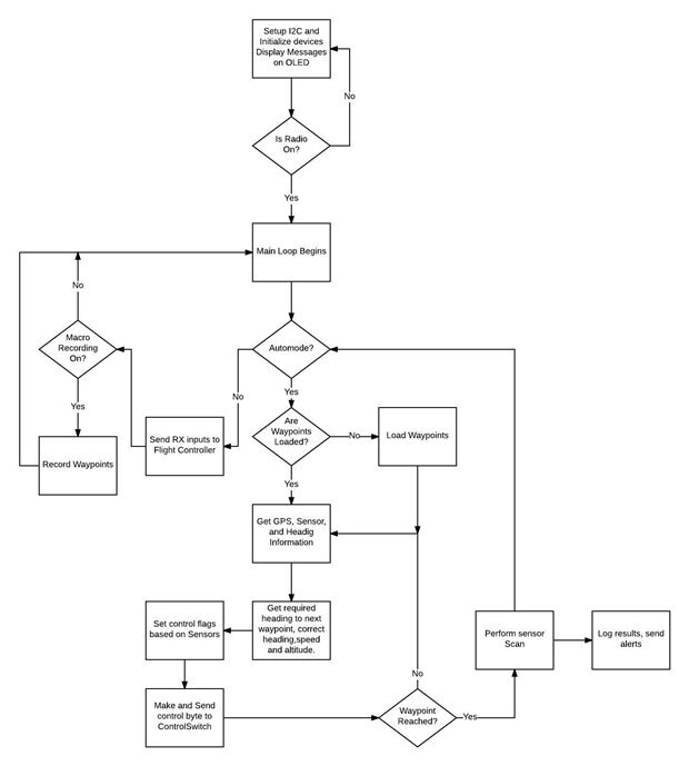

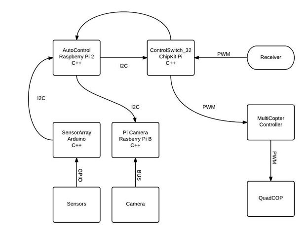

Well its time to post my source code.  Everything is written in C++ across 3 platforms.  The Pi 2, ChipKit Pi, and Arduino.  I used some advance features in C++ such as I2C, buffered serial communication, and PThreads.
I uploaded everything to GitHUB and still have an update to do to get the latest major version, as well as clean out some junk.  The GitHub is located at
https://github.com/screamingtiger/QuadCOP
Here is the Manifest.  All code is completely custom except TinyGPS++ and the Adafruit library for the OLED.  However I have made wrappers around this code.

autocontrol.cppMain control code for the Raspberry Pi Flight System (RPFS).
Gets sensor information and responds to events.
Navigates and records waypoints.

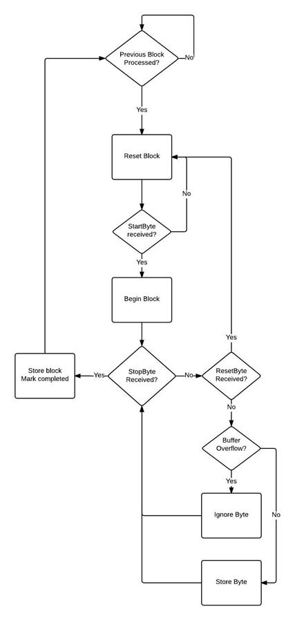

i2c.cpp, i2c.hBlock send algorithm for sending complex I2C dataWiringPiRaspberry Pi

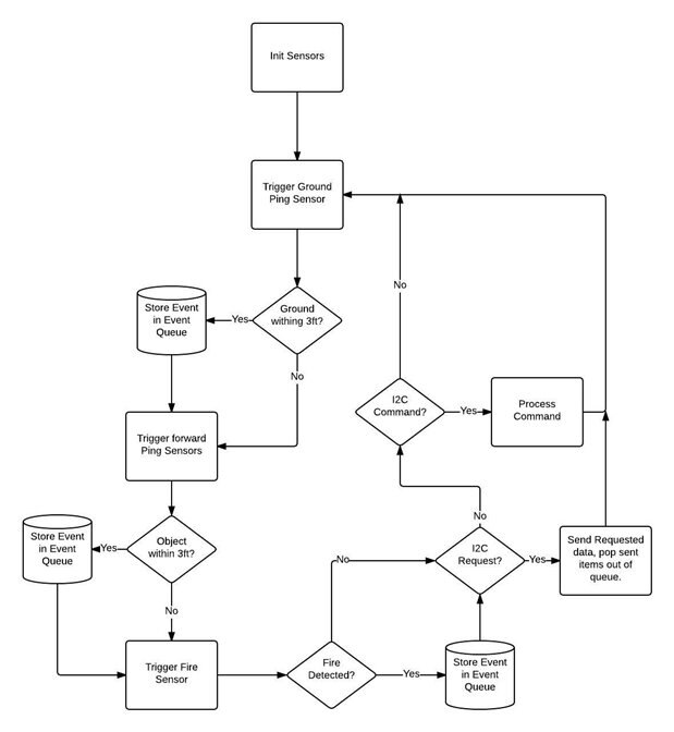

sensorarray.cppMain code that reads sensors and sends data via I2CArduino Wire libraryArduino

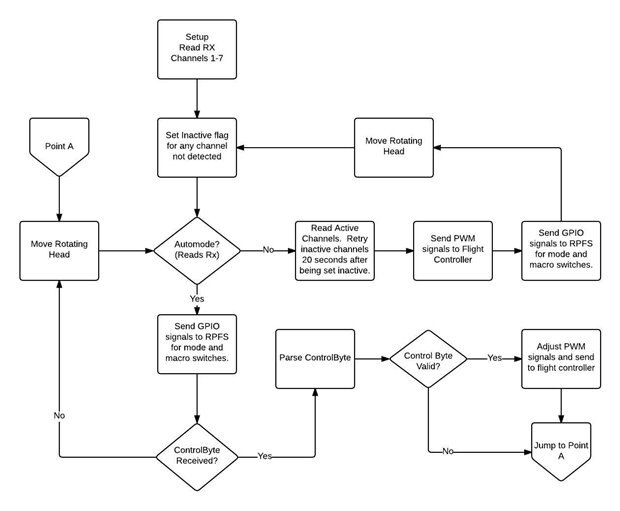

controlswitch_pic32.pdeMain Control switch code for reading and sending PWM signals for flight controlChipKit Wire and SoftPWM librariesChipKit Pi/PIC 32Also controls rotating head

Software Interconnection Diagram
autocontrol.cpp (RPFS)
controlswitch_pic32 (ControlSwitch)
sensorarray.cpp (Sensor Array)
I2C Block Protocol
