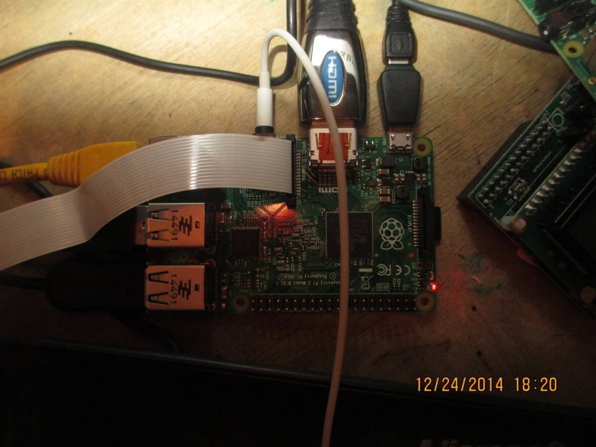

One more announcement - I have successfully booted my Raspberry Pi 2 and checked its performance. What can I say?
  1. It can easily perform as a desktop PC for developing this project, for example. Still nothing like 50 browser tabs without lag, but it's pretty much awesome - certainly better than RPi 1 =) I feel like I could make the entire project using it.
  2. With supplied MicroSD card, you don't get raspi-config fully working (no proper memory division dialog or camera function) until you do apt-get update&&upgrade. But then, it's much faster than it used to be, so that little detail doesn't matter =)

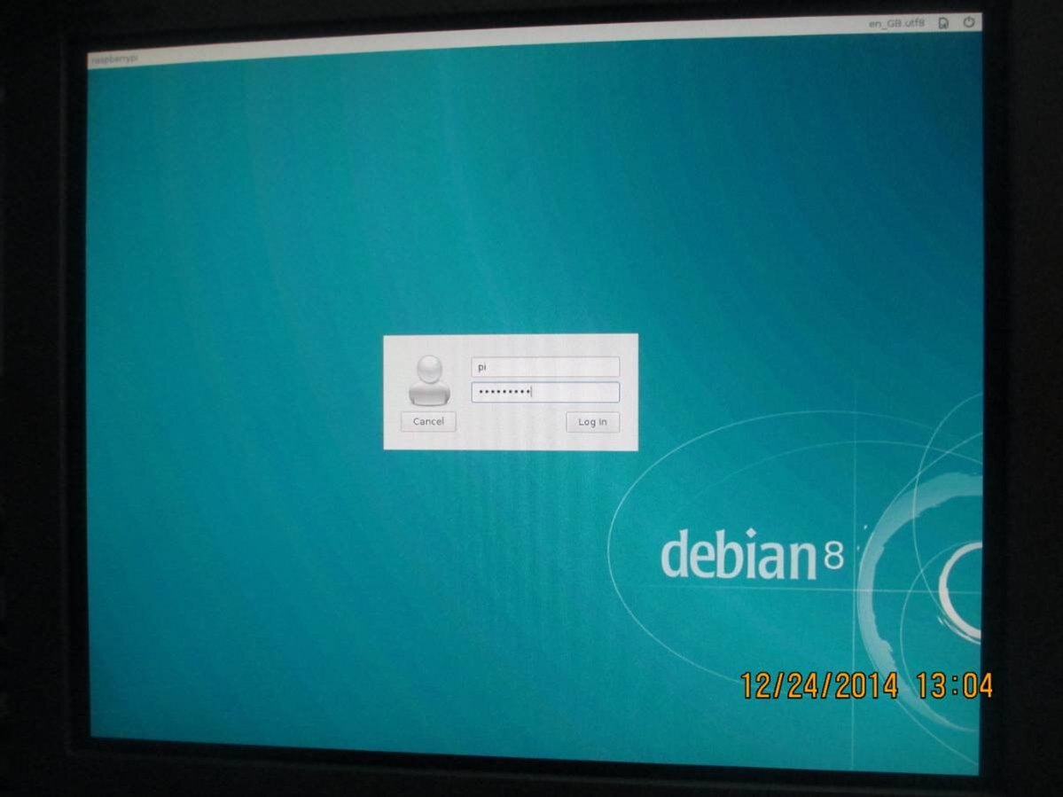

Update it is, right? Well, let's see! Now, I'll show you how to update from 'stable' to 'testing'.
  1. Backup your SD card (I didn't LOL) - you better do it with dd from another Linux PC(link), for Windows there's Win32DiskImager.
  2. Boot your Pi from it. Launch the terminal and type:
sudo nano /etc/apt/sources.list
        There's a single uncommented line - our only repository. That simple. Right at the end of repository URL, there's 'wheezy'. Replace that with 'jessie' and close the file saving changes.

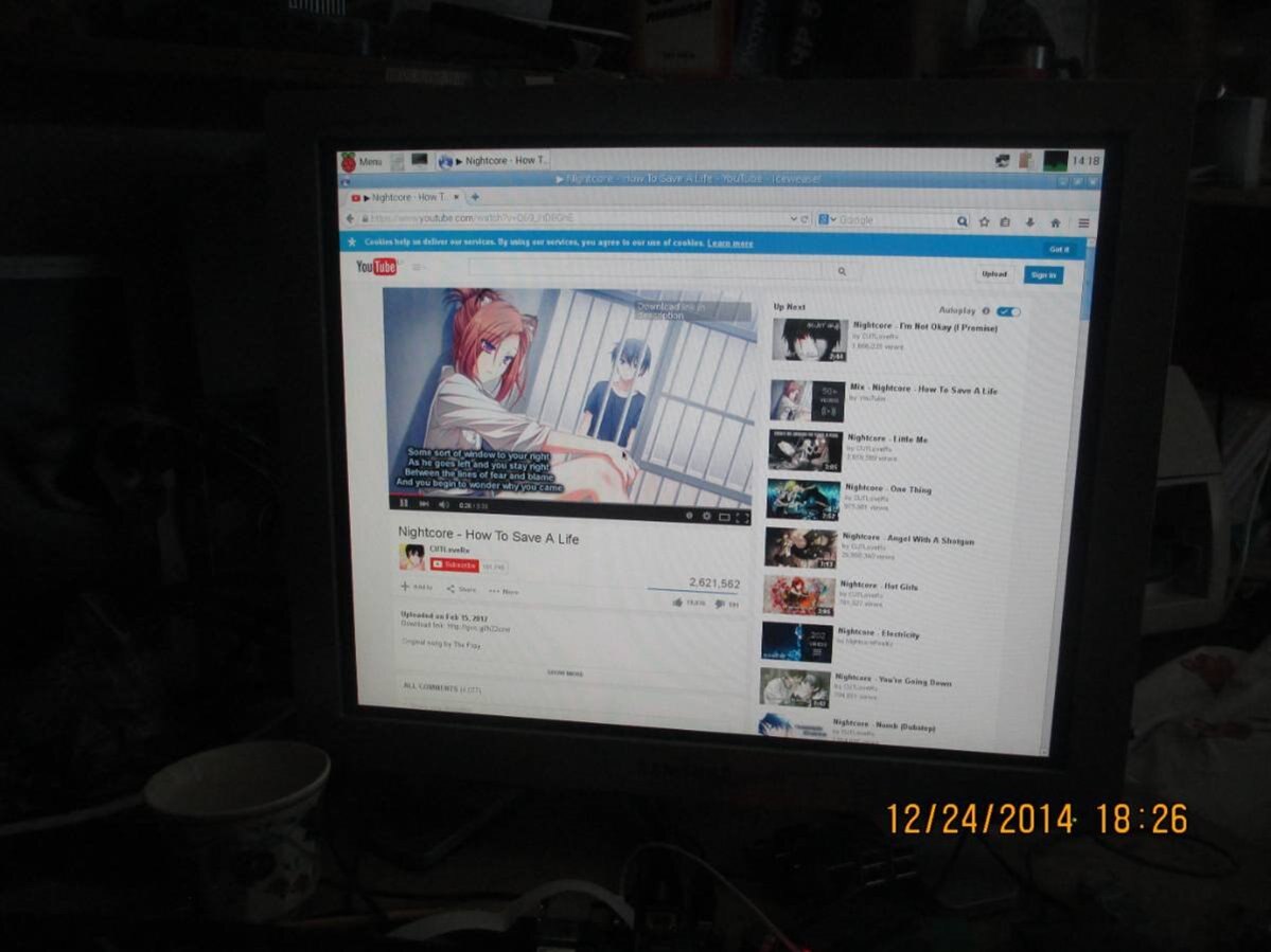

  • You'll get broken Epiphany and Chromium, at least at this moment =D I just switched to Iceweasel after some hours of reading gdb backtraces, and removed both offenders from the system. Sorry, folks, I didn't bother reporting the bug in Epiphany. My bad, I am realy busy now and this reporting stuff is quite new for me =(
About Chromium - its version in Raspbian repos is frozen at 22.something, when recent versions are 44 and so on. My opinion? Forget about Chromium. Here's a link that has some explanation.
Personally, I found Iceweasel quite good and already managed to code some things for my project using it to google things, while watching YouTube videos =) BTW, HTML5 is there and properly working, yaaay!

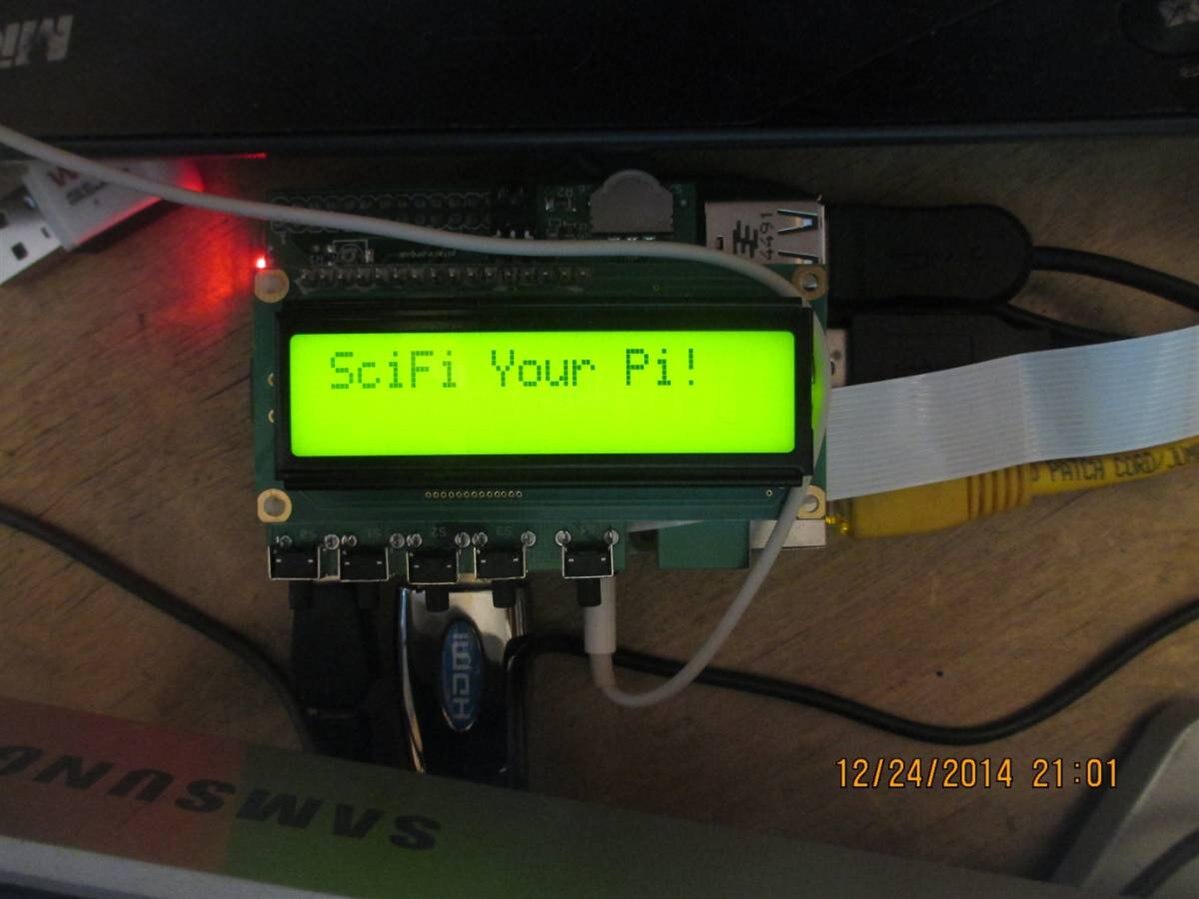

But I did integrate PiFace Control and Display device screen into my Wearable Control System. The corresponding WCS repository branch is here, it's quite a dirty job as for now (heck, I basically threw out a lot of helper functions I made before for future expansion) and only shows that it's working, but I'll certainly integrate it properly =) Keys on the PiFaceCAD are not integrated yet, too. Just quick hardware test. Here, watch this video!
It's the essence of my WCS framework. You can see keypad-controlled prototype menu system with submenus, all callback-driven. See that "Third function selected" in the end? It's a function I activated by using this menu, and it could be anything you'd want it to be, for example, SMS sending function =) There's a lot to be done to make it work, such as enabling it to work with some form of RPC (you don't want to 'import' every program that uses screen and keypad in the control module executable).
That's all to it. I'll keep you updated. This post was written from my Raspberry Pi 2 =) ...Okay, not quite. Javascript performance still sucks, even with 4 cores. Also, it keeps throwing those undervoltage notifications and I feel like things will not work properly until I replace the power supply. So I used i5-based Windows laptop just to finish publishing the article - I do want to sleep now, and waiting for letters to actually appear after I have typed them is not the best way of publishing an article. See you all!image
UPD: Just realised I had my Pi slightly underclocked. I think I'll retract that statement for a while =)
Oh, and it does crash when you shine a camera flash at it! I was wearing headphones when I decided to check if it does, triggered the flash and was deafened by a sudden buzz in headphones (was listening to music, probably PWM had continued with the same frequency as it had at the moment of crash). 0/10 wouldn't flash again.
