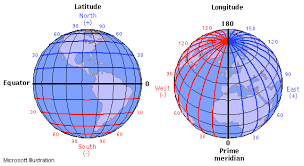

Having got the GPS working I could now get the GPS position for the current location and then compare that with the intended destination. The next challenge was to decide on some suitable destinations and to get the latitude and longitude for those places.
After a quick think I selected a short list of possible destinations to test the functionality (which would also act as start points for the route indication):
1. Sheffield
2. London
3. Perth
4. New York
5 St Petersburg
These destinations were chosen as they were visible on the map I had selected (and being based near Sheffield it would be easier to test using that as one of the destinations. They are also major cities that may feature in a steampunk adventure.
using Latitude Longitude Finder on Map Get Coordinates I came up with the following list.
1. latitude: 53.381129 longitude: -1.470085
2  51.507351  -0.127758
3. -31.953513 115.857047
4. 40.712784 -74.005941
5.  59.920613 30.322952
To test the device have set up these as variables and compare the position and print N or S and E or W to indicate the direction. Once the device is put together these would set a GPIO pin high to light an LED under the appropriate arrow.
To decide which way that the adventurer needs to travel the device needs to calculate the difference between the current location and the destination.
To calculate the direction to travel the latitude and longitude numbers of each location are compared. There is two ways to compare the numbers and indicate the direction to travel thatIi have considered.
The first is to simply take the destination figures away from the current location figure. If the result is a negative number then the destination is south (for latitude, west for longitude) of the current location so the adventure is shown the South arrow (West arrow for longitude) to move towards the destination. This gives a quick comparison and points the traveler towards the destination. The problem with this method is that if the destinations are at the edges of our flat map (with 0 0 at the centre) then the direction indicated could be moving all of the way around the world in the oposite direction to the one which would be the shortest way to get to the destination.
To correct this difficulty and travel in the shortest direction a correction need to be applied. To do this the difference can be used to check if the two positions are closer in the initial direction or by traveling in the opposite direction. This is actually simpler than it sounds as we just need to check if the difference is larger than 90 for latitude and larger for 180 for longitude then the traveler would be best served traveling in the opposite direction to that indicated above.
