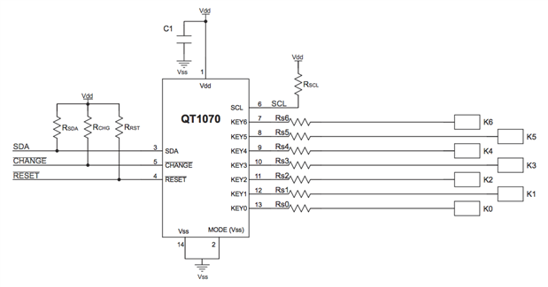

In comms mode, the sensor can have up to seven input keys and interfaces with a master microcontroller or SBC via I2C. The I2C interface can for example also be used to configure sensitivity of the different input keys. A typical connection diagram for comms mode is the following (as provided in the datasheet):

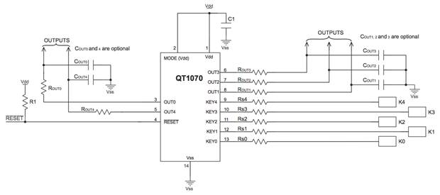

The other mode, standalone mode, does not make use of the I2C interface but rather converts up to five capacitive touch inputs into digital outputs. This is useful to convert digital inputs on a microcontroller board or SBC into capacitive touch inputs. Because the I2C interface is not used, sensitivity of the touch inputs cannot be configured and is static. The connection diagram for standalone mode is the following:

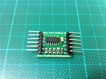

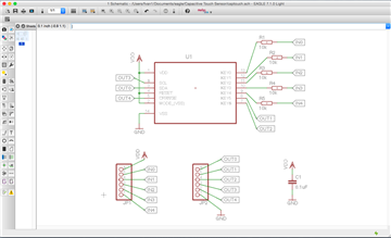

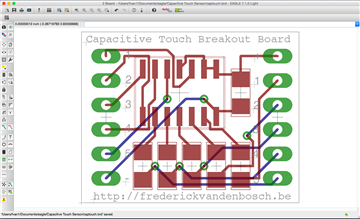

I chose to make a breakout board for the standalone mode. The circuit is simple as it only involves the touch IC, a couple of resistors and a capacitor. It was a bit trickier to fit everything in the smallest form factor possible, but that worked out well as you can see below.
The schematic and board were created using Eagle and the AT42QT1070 component was downloaded from the Farnell page of the part (AT42QT1070-SSU - ATMEL - SENSOR, QTOUCH, 7-KEY, 14SOIC | Farnell element14).
This is only a first version. I'll be releasing the files after some possible improvements, such as:
  • including pull-up resistors for the input pins rather than relying on the attached microcontroller board/SBC using internal pull-ups
  • LED indicators to show which input is active, as this may be useful for easy troubleshooting

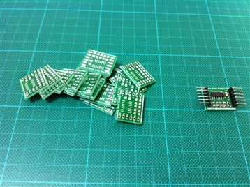

To get the PCB done, I used SeeedStudio. The service is cheap, at about $12 for 10 boards, including shipping. The only downside is perhaps the fact that it takes two weeks between ordering and receiving the boards. While waiting for the PCB to arrive, I ordered the parts so I could populate the board once it got here. I purchased the AT42QT1070AT42QT1070 from Farnell, the other bits I had available.
Once all the pieces were available, I took out the soldering paste, heated the pre-heater and hot air rework station, laid out the components on the board and reflowed the solder. The result can be witnessed in the pictures below. To see the whole process, be sure to watch the video at the end of this post.
Before hooking up the board to something else, I used my multimeter to check all the connections were correct and no shorts were introduced while soldering.
