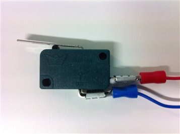

Endstops (also know as "limit switches") can be very useful to stop motors when an end position has been reached. This is for example the case with 3D printers or CNC milling machines where the motors controlling each axis, back up until the endstops are triggered. This defines a reference point, also called "home position" with coordinates 0,0,0.
There are different types of endstops, just to name a few:
  • mechanical: an ordinary switch makes or cuts a connection when triggered
  • magnetic: a hall-effect sensor is used to measure the magnetic field
  • optical: a sensor reacts to sudden changes in light levels
For this guide, I'll be using mechanical endstops, such as the one on the right.

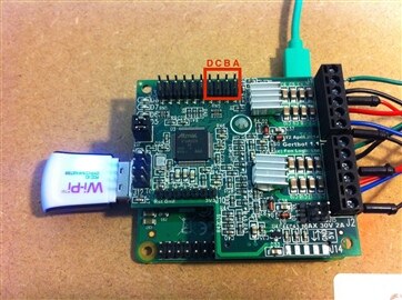

Four pairs of endstops can be defined: one pair per motor channel, covering two extremities. Seen from the top of the Gertbot, the endstop pairs are positioned as such:
The endstop pins are connected to 3.3V using a 4.7kOhm pull-up resistor.

The endstops can be configured in three different modes:
  • OFF (0): don't enable the endstops
  • ENDSTOP_LOW (1): enable endstop, stop motor channel when switch to GND is closed and pin is LOW
  • ENDSTOP_HIGH (2): enable endstop, stop motor channel when switch to GND is open and pin is HIGH
When using endstops, the safest option is to use the ENDSTOP_HIGH mode, as a broken endstop wire would result in the motor channel to be disabled, ensuring the safest state.
