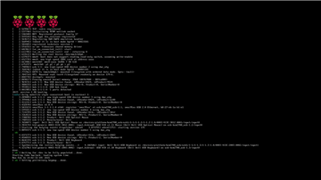

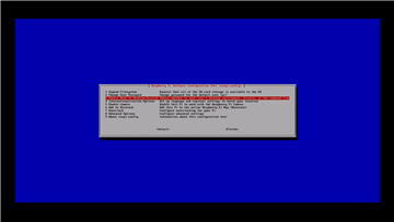

After having connected the necessary peripherals such as keyboard, mouse and monitor and having inserted the preloaded microSD card in the designated slot, the Pi is powered on using a 5V/2A microUSB power supply. It seems that no distribution installation selection menu is offered upon the first boot, instead, it appears like Raspbian is already installed. This is different from what I have experienced with a model B+ NOOBS Edition. During the boot process, four raspberries are displayed in the top left corner, indicating four CPU cores have been detected. Once the boot process completes, the Raspberry Pi configuration tool is automatically launched. The configuration tool can be used to configure basic things such as the hostname or wether to boot to the console or directly to the desktop, but also more advanced things such as I2C, SPI, camera support, etc...

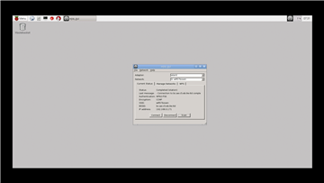

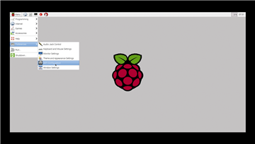

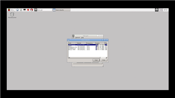

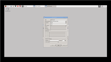

Instructions on how to configure Wifi from the graphical environment are provided with the element14 WiPi dongle, but work just as well for any other wifi dongle. First, connect the wifi dongle while the Pi is powered off, when done, power on the Pi. Using the menu in the top left corner, go to "Preferences" > "WiFi Configuration". Press the scan button at the bottom of the wpa_gui application and double-click the SSID of the wireless network you would like to connect to.
Enter the password of the selected wireless network and click "Add". If all went well, the Pi should be connected to the wireless network and an IP address should be displayed.

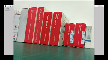

Camera

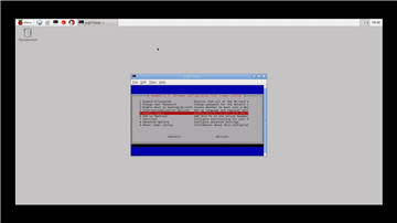

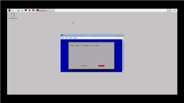

Connecting the camera module to the Raspberry Pi 2 is identical as with previous models. Ensure the camera's flex cable is inserted in the CSI port near the ethernet port, with the exposed contacts facing away from the ethernet port. Once connected, the Pi can be booted. Before the camera can be used, support for it needs to be enabled. This can be done by running following command in a terminal:
  • sudo raspi-config
This launches the Raspberry Pi configuration tool, which was also presented during the first boot. Menu option 5 allows to enable camera support, and requires a reboot to apply.

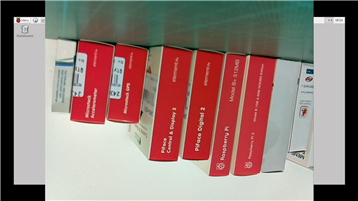

After having enabled support and having rebooted the Pi, the camera can be used. In a terminal, use following command to make a picture:
This will create a file called "test.jpg" after a five second preview on screen. In case the image's orientation is not correct, it can be changed by adding the horizontal and/or vertical flip options to the command:
  • sudo raspistill -o test.jpg --hflip --vflip
