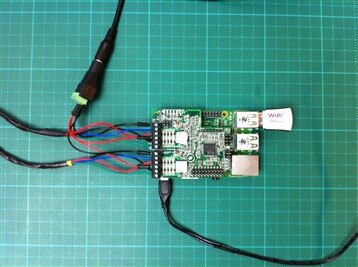

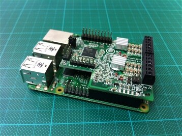

The first step is to connect the Gertbot to the Raspberry Pi, but before doing so, ensure the Pi is powered off. Take the Gertbot and connect the 26-pin header, starting from pins 0 and 1. The Gertbot should slide in nicely next to the ethernet port, without touching it.
The result should be as follows:

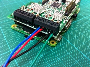

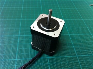

As for the hardware, I used two 200 steps, bipolar, 12V NEMA17 stepper motors and connected them to the Gertbot as per the documentation. The underside of the Gertbot also indicates how to connect the motors.
