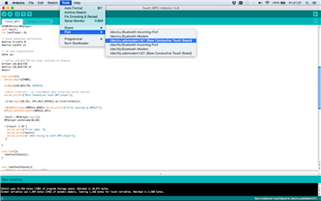

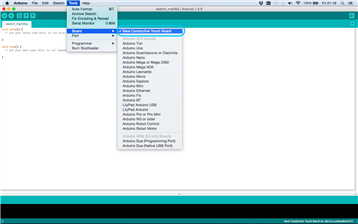

Hardware
The hardware plugin ensures that the Arduino IDE is able to recognise and program the Touch Board. It can be downloaded from Bare Conductive's GitHub page and needs to be put in the Arduino IDE's hardware folder. It is possible to verify the hardware plugin has been correctly installed by starting the Arduino IDE and confirming it is available in the list of boards.

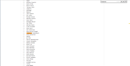

Note: There's even a "Thank you backers" file in the repository in which I found my name. Awesome!

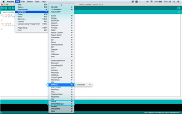

Libraries
A total of three libraries need to be installed/updated:
  • MPR121: capacitive touch chip
  • SFEMP3Shield: MP3 chip
  • SdFat: microSD card
The MP3 chip and microSD card libraries are bundled together in a single zip file. Once the libraries are installed by extracting them in the Arduino IDE's libraries folder, the programming environment is ready.

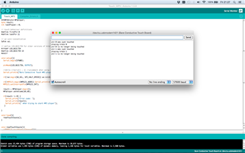

Code
The code for the pre-installed audio guide is available for download. Once opened in the Arduino IDE, it can be used to understand how the application works and how the board could be reprogrammed for other purposes. Because the Touch Board is recognised by the Arduino IDE, the serial monitor can be used for troubleshooting purposes. In the case of the pre-installed application, it shows which electrode has been touched and which audio track has been played.

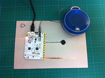

I've been experimenting with materials such as copper tape, aluminium foil and electric paint. Alligator clips can be used to connect the sensors to the Touch Board. Alternatively, the connection could be made by applying electric paint to the electrode, this method is called "cold soldering".

Project
I'm currently working on a project in which I'll be using the Touch Board to integrate capacitive touch controls into the surface of a desk, triggering certain actions with accompanying sound effects. A first test is demonstrated in the video below, in which hidden controls are triggered by hovering a hand over a piece of cardboard.
