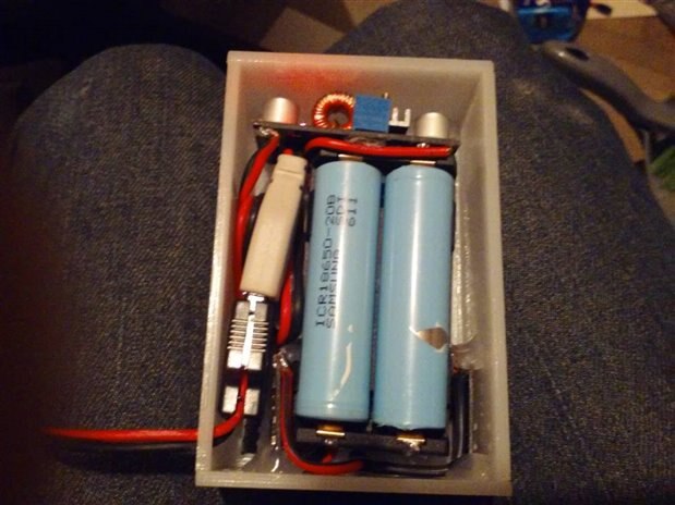

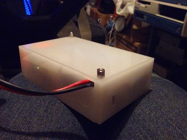

Here's a powerbank that I've developed to power my portable Raspberry Pi on the go. It's 2 Li-Ion cells from laptop batteries in series, with a step-down DC-DC to feed stable voltage to the Pi effectively, as well as charger&protection module connected to each battery slot. It has a USB socket which can be kept inside the housing together with USB plug connected to it, as you can see - saves some broken wires! The casing is made from 3mm PMMA, and is too bulky to be wrist-worn. I'm already planning to make a waistbelt attachment, and I've made a wire long enough =) As for now, this gives 7 hours of uptime before the batteries are fully discharged, and this is with possibly with the most consuming RPi board. Fitting a RPi B+ will double the rating, and I won't even mention RPi A+ =) This is without many peripherals, though. It also needs to have its corners rounded, as well as to be painted black - as well as this one:

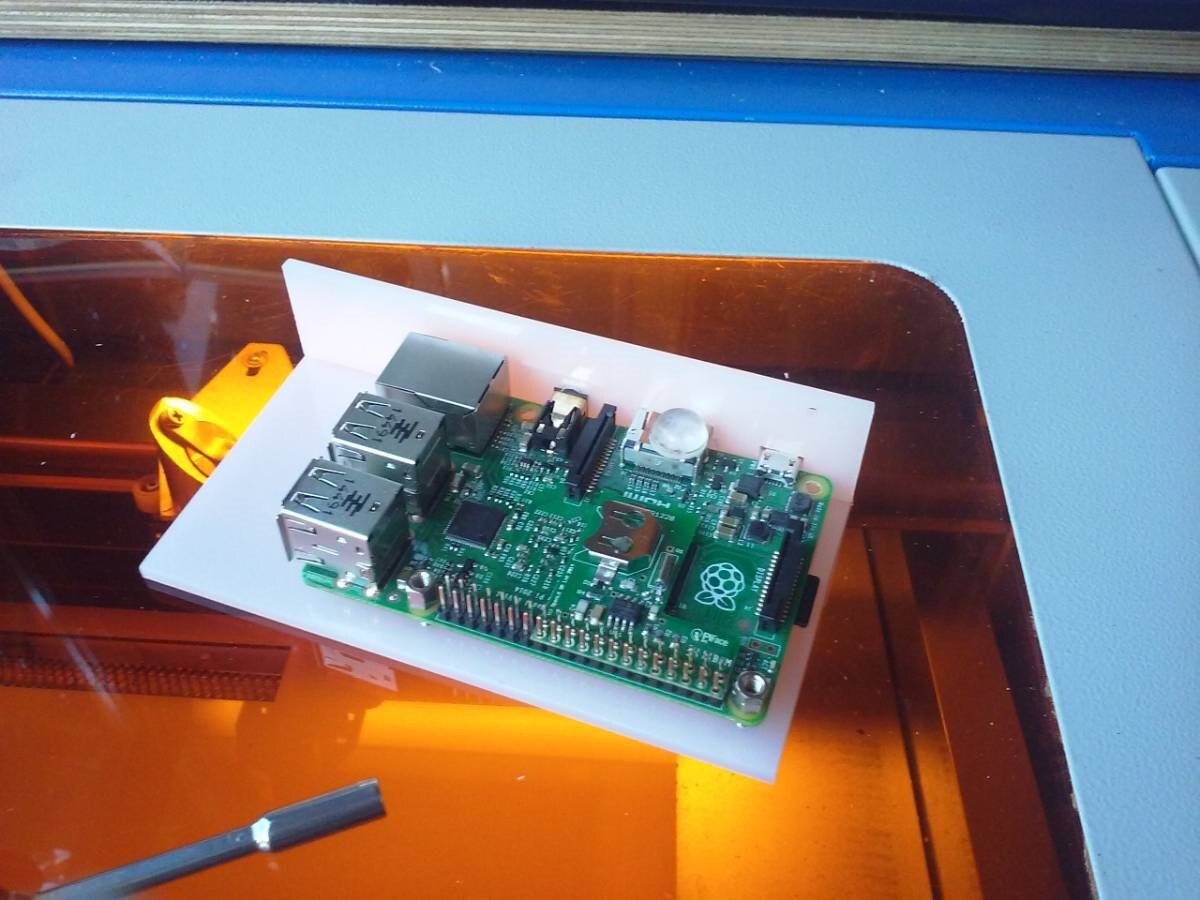

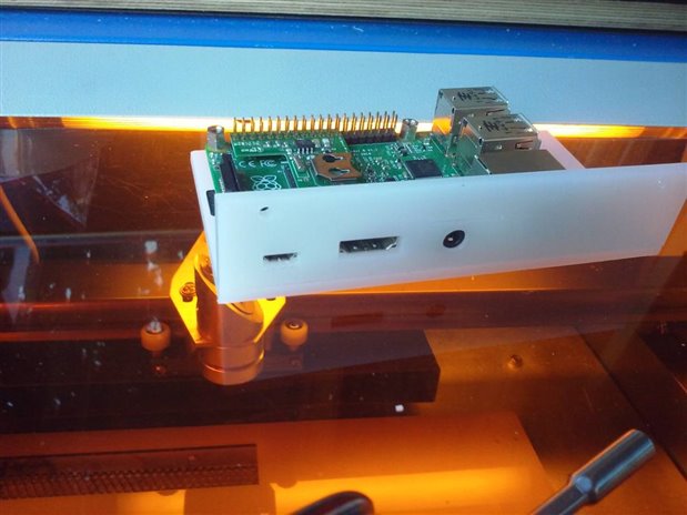

This is base + one wall of the Raspberry Pi casing, the main module of my creation. It's gonna have most of the sockets on RPi accessible one way or another, as well as have some space inside for USB peripherals and the Ethernet jack - and you can see the laser cutter I'm using =) I'll talk about minimizing it in next series, as well as show how you can connect many peripherals to it in a creative way that applies to any RPi.

    I agree, softening the edges will be better for wear ability.
