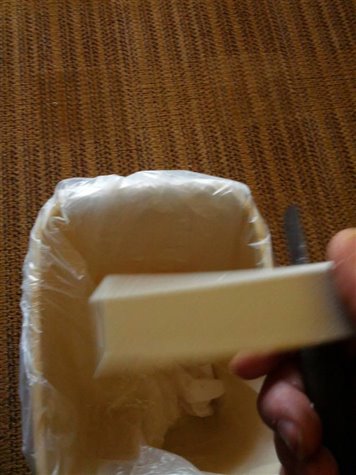

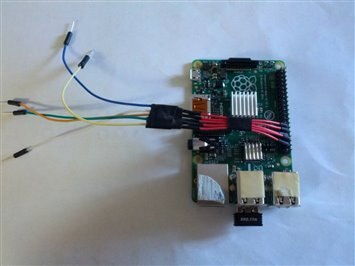

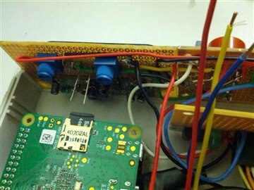

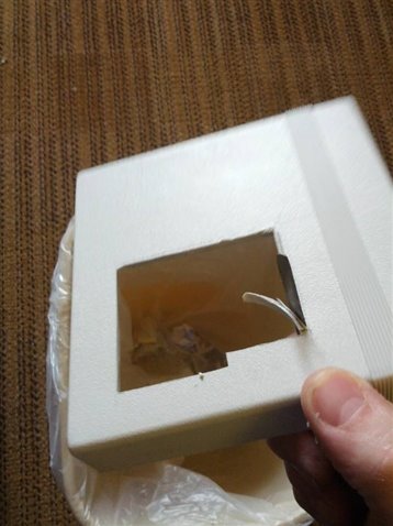

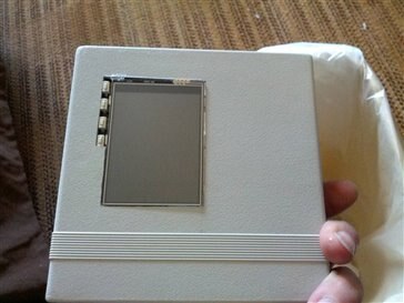

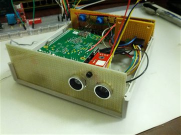

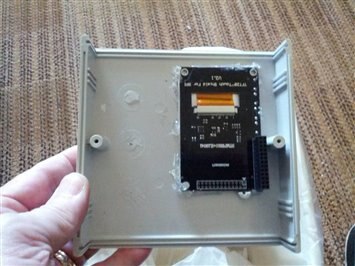

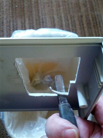

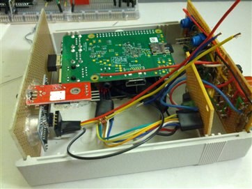

This past weekend was fairly intense with picorder activity as indicated by the enclosed photo gallery. Construction continues as I carve out the case by hand for the TFT display complete with four momentary contact switches. We'll soon find out if I can incorporate them to be functional with the scripting, or at the very least to gracefully shutdown the picorder. Sensor array taking shape also with physical placement. So far the flame detector, distance/echo sensor, temperature/humidity sensor and alcohol and Co2 sensors are in place. Wiring continues and scripting is ongoing. Parts list is partially compiled as forging forward towards deadline.

Picorder encasement
Small power board with 5vdc regulator and RPI B+
Flame and distance echo sensors
Front end sensor array
Replacing Model B with RPI B+ for more GPIO port usage
Carving the case
Old-fashioned carving with hand tools
Almost completed trimming
Display: Mounting
Taking Shape
Carved case for TFT Display
    e14 Contributor over 11 years ago +1
    Great to see it all fitting together! You must be getting excited bringing it to this stage and seeing your ideas take shape There's a fair few protoboards going on to hold and function the sensors, time…
    balearicdynamics over 11 years ago +1
    Nice work, it seems going well. If I can give you a suggestion, you can put a thick border (maybe printed on vinyl?) over the LCD to cover the carved borders and the pushbuttons (remaining active as the…

    saturnv over 11 years ago in reply to balearicdynamics
    I did have plans to use the plastic package from a proto-board and push it up from the inside and secure it to the case. Then mount the display so that it was covered by the plastic. It would have fit nice underneath the plastic protector, however the plastic wasn't as pliable as I wanted and it creased when I would push on a button. But thanks, great minds do think alike. For a prototype with only a few months to construct and complete, I'm impressed that we've all been able to get as far as we have! 'til later
    Nice work, it seems going well. If I can give you a suggestion, you can put a thick border (maybe printed on vinyl?) over the LCD to cover the carved borders and the pushbuttons (remaining active as the plastic cover is thick) giving a very trekker aspect to your work.
