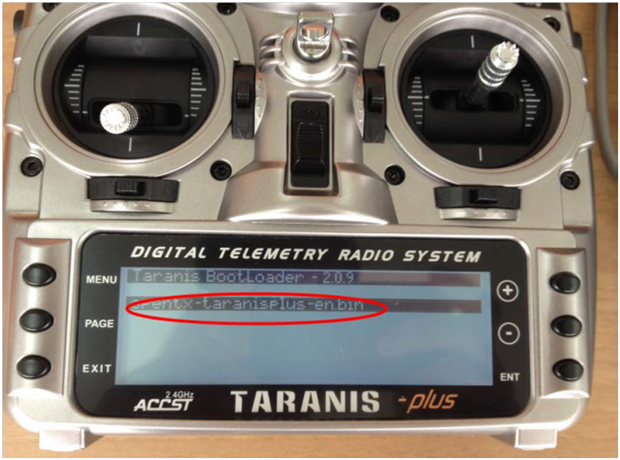

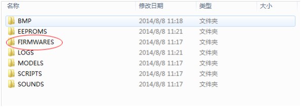

The first thing to do is... to upgrade the transmitter firmware. This is required not just to have the latest version, but because the European version of the transmitter is shipped with a firmware that does not support D8 modulation, which is the only modulation supported by the receiver I installed on the TrainingSphere.
Upgading the firmware is very easy
  1. Remove the TF card from the card slot of TARANIS Plus battery compartment, and insert into the computer's SD reader
  2. Download the firmware from FrSky website download section and copy the .bin file into the “FIRMWARES” folder on the SD card
  3. Insert the TF card back into the card slot of TARANIS Plus battery compartment.
  4. Turn on the transmitter while pushing T1 and T4, the screen will display "Taranis Bootloader". Choose "Write Firmware", and then press the ENT button.
  5. Select the bin file that you’d like to upgrade to and then press the ENT button.
  6. Wait and succeed, turn off the transmitter.

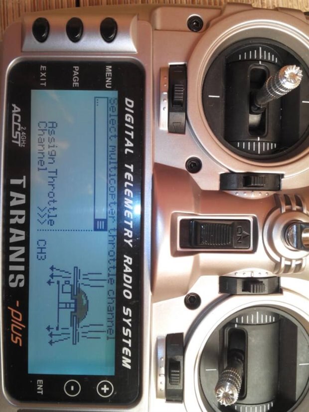

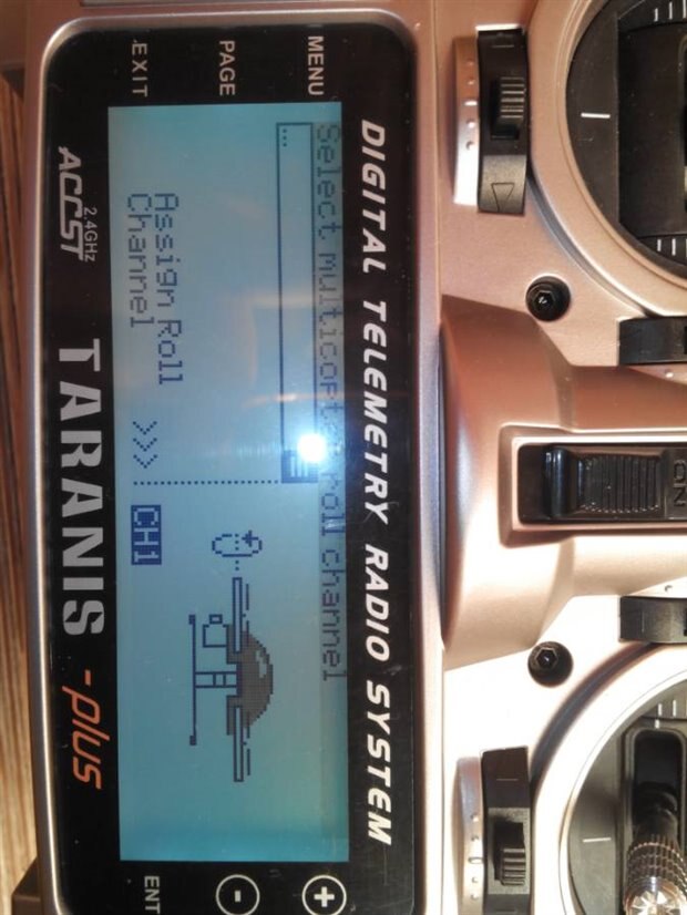

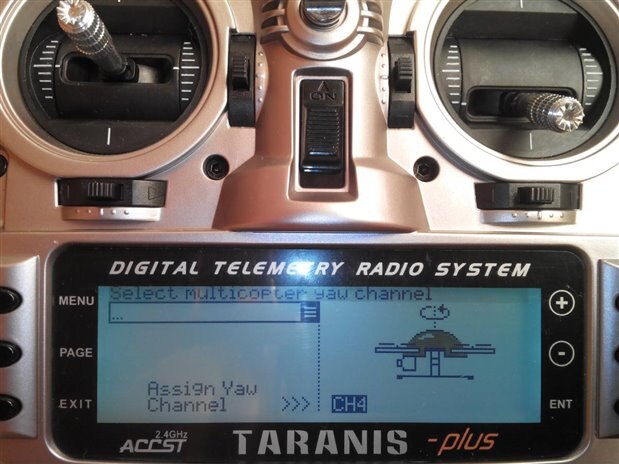

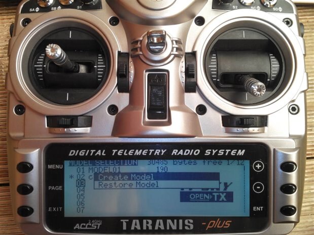

I created a new model for the training sphere

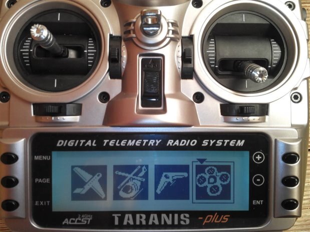

I selected the multirotor option, as this is the most closed to the training sphere. I initially selected the "helicopter" option, but in this case you will be asked to select the channels for cyclical, tail rotor, etc
Then I choose the proper channels for each command, namely throttle, pitch, roll and yaw
