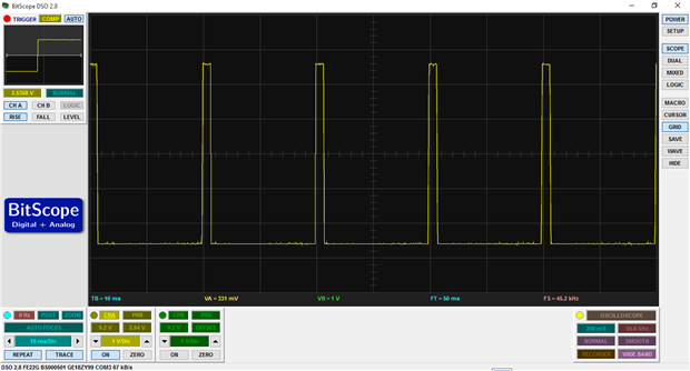

So I connected the Bitscope to the PWM output as I saw something really strange...
The frequency of the PWM signal was incredibly high: 250 Hz, whereas it was assumed to be 50 Hz

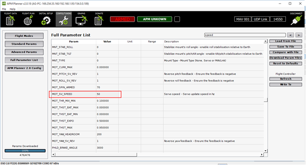

It took me a lot of time to find out that there was one parameter (MOT_SV_SPEED) that was set by default to the wrong value!

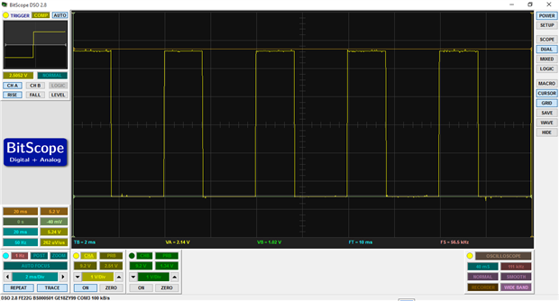

After I changed the value from 250 to 50, the PWM output was perfect
Now the servos (I mean, the survived one) run smoothly and without vibrations
