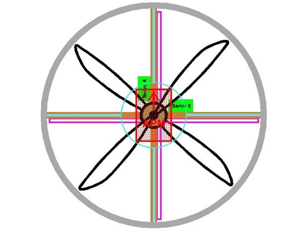

The selected configuration has a coaxial rotor with counter-rotating blades. This configuration has many advantages
  1. compactness: the two propellers allows this configuration to reach a greater thrust with smaller propellers compared to a traditional helicopter
  2. the counter-rotating propellers gives intrinsic stability to the drone
  3. only two servos are required to control the drone, compared to the four servos required to control a single rotor helicopter

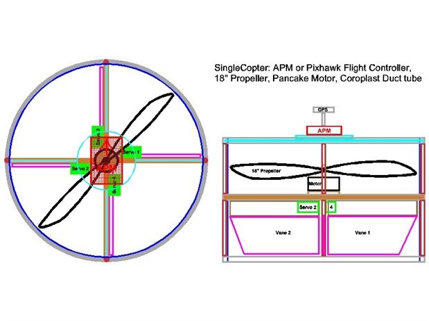

Just for the sake of understanding, here is the the single rotor helicopter configuration
and here is the coaxial  helicopter configuration (the configuration I selected)

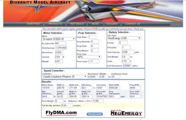

I was initially confused by the number of parameters involved in the selection. Fortunately, I found this very useful tool that allows you to easy calculate a number of parameters
Thanks to this tool, I have been able to compare different configurations.

The thrust required to lift off is typically said to be three times the weight of the drone, so I need at least a thrust of 1800 grams. Because I have two motors, each motor have to able to lift off 900 grams. After several attempts, I think the best trade-off between propeller size and thrust is a 9 x 6 propeller. In particular, I selected a propeller made by APC, which are said to be very good in terms of quality and lightness.
Once selected the propeller, I played a bit with the motor combo box and I finally made up my mind to used a 980 kv brushless motor. In this configuration, the efficiency is as high as 83%, which leads to a time at full throttle of about 6 minutes. Not that much, but I don't expect to need full throttle all the time!
