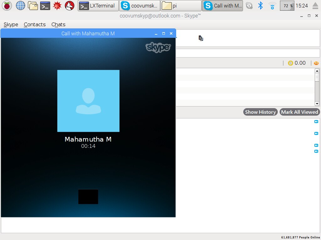

    I have installed the skype application in RPi2 ( Reference Link :- https://eltechs.com/run-skype-on-raspberry-pi/ ). I can able to establish the call from skype application of RPi whereas i am unable to establish the video call from RPi.  I can able to see the attached camera module in video devices under options menu of skype whereas if i made a video call, i can able to see only small black screen. Can anyone please help me out to resolve this issue?
