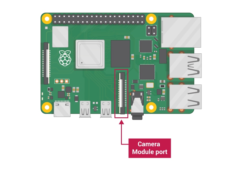

Raspberry Pi Board has CSI (Camera Serial Interface) interface to which we can attach the PiCamera module directly. Regardless of the chosen camera, the setup process always works similarly, as long as the camera is supported by the Raspberry Pi.
To attach the camera module to the Raspberry Pi, first make sure your Raspberry Pi is completely disconnected from any power source. Before removing the camera module from its grey anti-static bag, make sure you touch a radiator, a tap, or any other grounded metal object to get rid of any static that you might have built up.

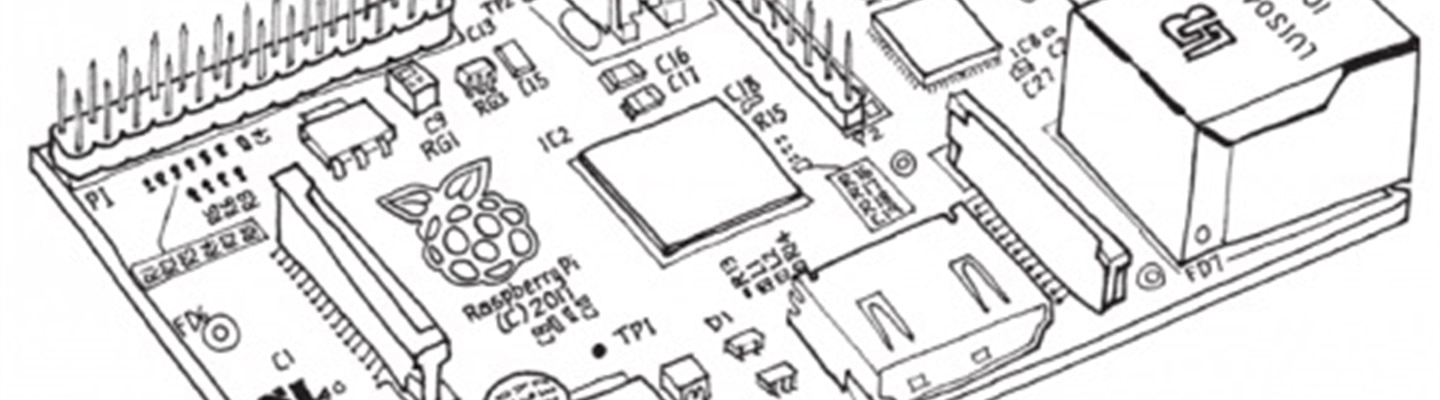

The camera board CSI connector is located between the Ethernet and HDMI ports on the Model B Raspberry Pi. The Ethernet port does not exist on a Model A board, but the camera connector is in the same place.

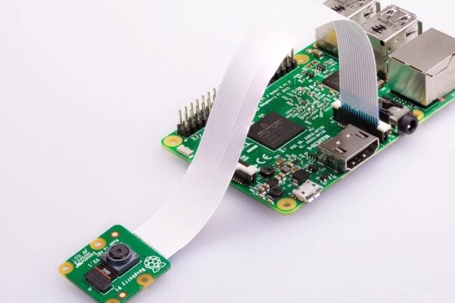

Open the connector by pulling the tabs on either side of the connector upwards and towards the Ethernet port. You should then be able to insert the ribbon cable on the camera module (with silver connectors facing towards the HDMI port) into the connector. Hold the cable firmly in place, and close the CSI connector by pushing the top part towards the HDMI port and down. It should click into place nicely and hold the camera ribbon cable securely.
Raspberry Pi will look like following after installing the camera.
