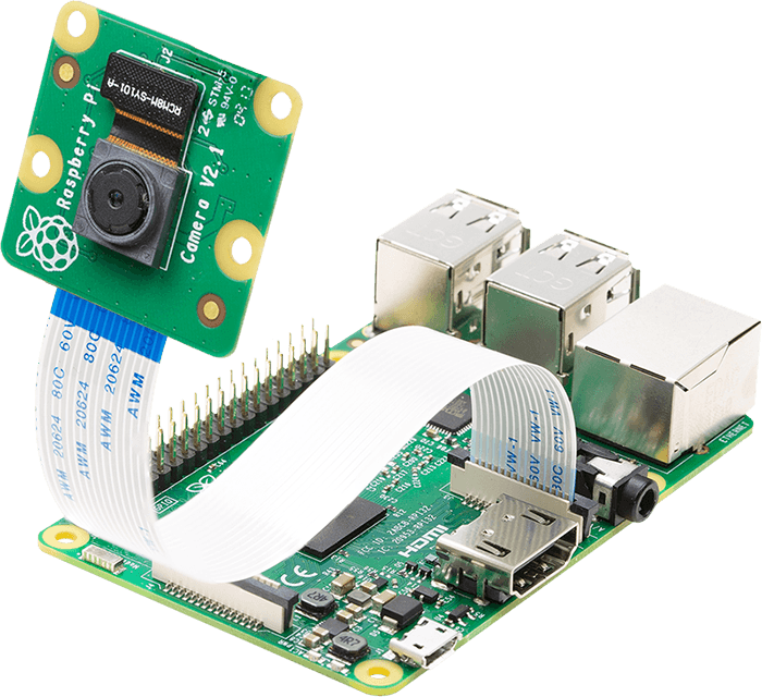

After some fail steps I was thinking for an alternative solution of the above mentioned problem and fortunately one good alternative came to my mind. I can make a small camera-based device that will be placed on top of the display of the measuring device. The device will then take a snapshot of the display while showing the right measurement and will extract the text from the image. The text will then be transferred to the desired microcontroller unit or cloud server.  By this way a single device can be used for logging the required data from any type of digital equipment that has a digital display. The problem is solved!
A raspberry pi will be a perfect hardware for the proposed system. The official Raspberry Pi camera will be used to take the snapshot of the display. Python based image to text converter algorithm is already available in the internet which can be used very easily for this project with a light modifications. As the Raspberry Pi has built-in Bluetooth and WiFi so data can be shared with other device or upload to the cloud very easily.  In some cases GPIO of the raspberry pi can be used for extra functionality such as adding extra sensors or actuators.
 The Required Hardware
  1. Raspberry Pi (I am going to use Pi 4)
  2. SD Card (16GB)
  3. Raspberry Pi Camera Module
  4. Power Adapter for Raspberry Pi (5V, 3A)
  5. Monitor
  6. Keyboard & Mouse
