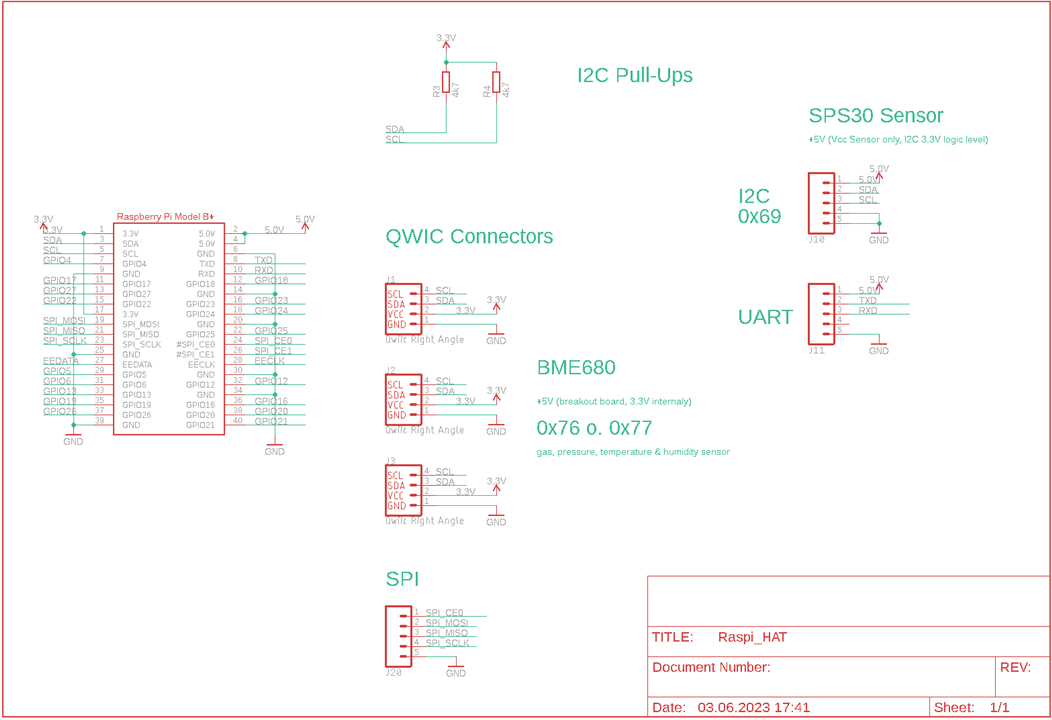

Schematic and PCB
The schematic and PCB were designed in a free version of Eagle and manufactured by JLCPCB.
The schematic/PCB does not only connect the SPS30 Sensor to the Raspberry PI via the HAT connector, but I have also added QWIC connectors, so you can add your favourite Adafruit or Sparkfun board to the Raspi. In my case, I have added a BME680 Adafruit board, in order to get even more environmental data like temperature and humidity and air pressure.
4466.SPS30_QWIIC_HAT.zip
