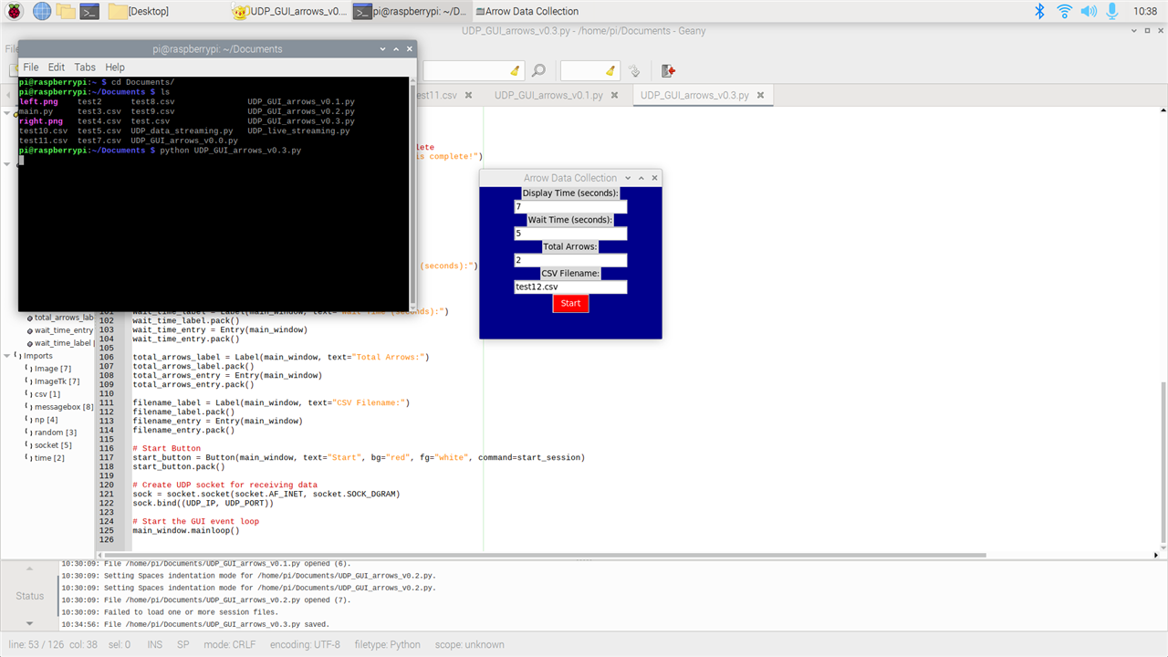

Graphic User Interface (GUI)
The next topic is the GUI I want to create for this project. There are already GUIs to conduct neuroscience experiments. A really popular one, that I am familiar with, is OpenVibe. It is a really powerful tool but there are no drivers for an ESP32 and I don't know how to write them. Maybe I could do something with LSL connection but still I am not familiar with actually writing these protocols.
Something I want to start is doing some basic motor imagery tasks. Mostly, with EEG we can detect when we are thinking of a physical movement without actually performing the movement. The same brain areas are activated when we perform the motor movement or when we think of it. This can be really useful for people who suffer of any kind of movement impairment since they don't need to perform the movement to operate a machine but they can think of it. OpenVibe has a tutorial to use their motor imagery example and I want to replicate it. I am attaching below the link.
http://openvibe.inria.fr/motor-imagery-bci/
It is very simple, two arrows are showed one at a time randomly. When the left arrow is showed, the user think of a movement (like opening and closing the left hand). When the right arrow is showed, the user think of a movement (like opening and closing the right hand). Each arrow is showed after a period of rest so the brain activity starts from a rest state. The arrows are showed randomly since we don't want the user to see a pattern otherwise there will a bias in the EEG data. Finally, an equal amount of each arrow should be performed. So if a total of 40 arrows are showed, there should be 20 left and 20 right. If thy are not the same, there might be bias while using machine learning. I attached below what the BCI looks for now.

I am having issues with showing the left and right arrow in a different window. For now, I can just print it in the terminal but I want the arrows to be showed in a window of the GUI. The GUI asks for few general inputs, such as the display time (how long each session should be in seconds), wait time (how long the rest time should be), the total amount of arrows (which will be divided into 2), and the name of the file. For now, I didn't put any checking. I am not sure what would happen if somebody puts an odd number of total arrows (probably an error). Also, I want the GUI to automatically add the extension .csv and to check if there is already another file called like that.
The GUI reads the data sent from the Huzzah32 and record it while the session is on. When the wait time period is on, no data is recorded. The data is saved as a csv file with labels for left and right arrow for 8 GPIO pins. I am attaching below a screenshot of an example of .csv file. I need to fix how it is saving the data. I want each session on one raw of the csv file and each cell should have an array of dimension 16000 x display_time for each electrode. So if there are 40 total arrows, there should be 40 rows for 8 columns (plus the label column). For now, it is printing on a new row each data and it is not 16000 x display_time.
I think I will fix this issue by working first without the UDP connection. I will just use the GPIO pins from the Raspberry Pi4 to collect data and once I am happy with the results of the GUI I will add the UDP connection with the Huzzah32 board. By the way, I found a good tutorial to connect the an ESP32 board with a Raspberry Pi4 via Bluetooth. I might try it next week or the following week. Something that I don't like about the UDP connection is that I have to check the Raspberry Pi4's IP address every time and if it is changed I have to update it on the Arduino code of the Huzzah32.
