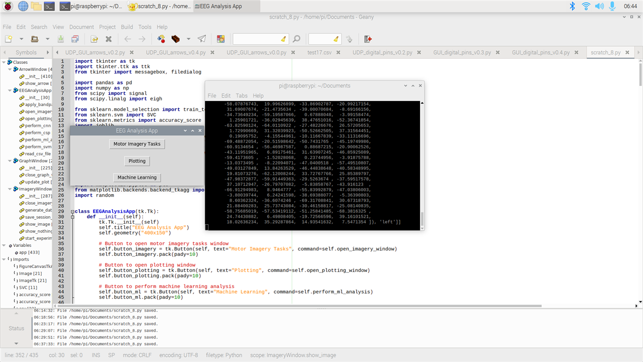

The Finished Graphic User Interface
After working for so long, I finally finished the GUI. The GUI has three main functions:

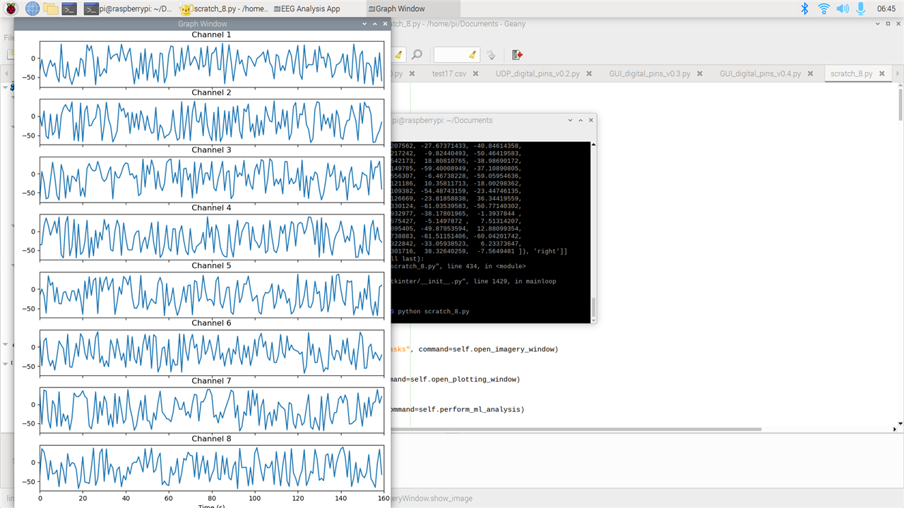

  • Plotting: it plots in real time from 8 channels

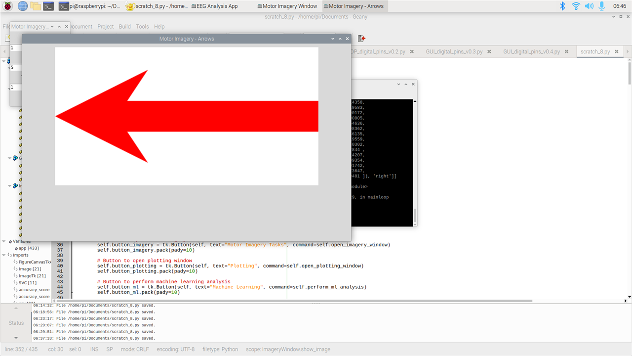

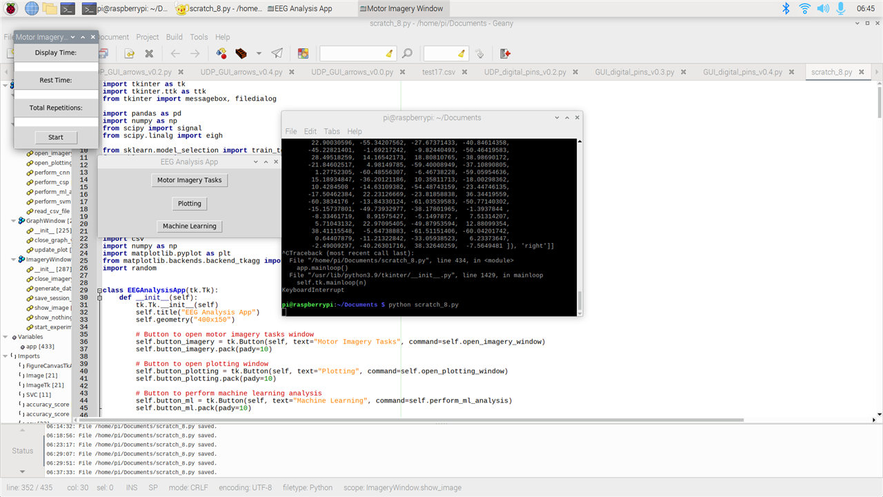

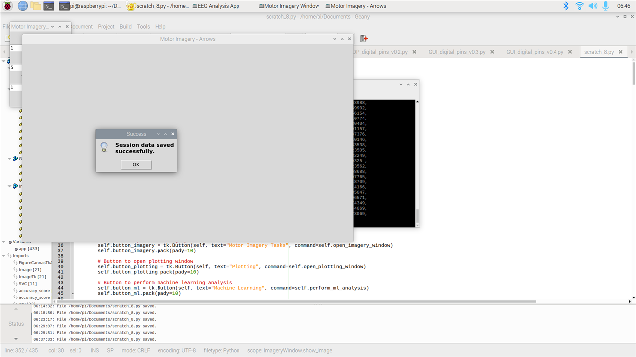

  • Motor Imagery Tasks: with this function, everybody can do a simple motor imagery experiment. Just as I explained last post, the function will show you a left and a right arrow one at a time. During that time, the subject will think of a movement (like opening and closing right or left hand) so to get data of motor imagery tasks from each individual. The experiment is completely customizable. You can input the display time, resting time, how many sessions, and where you want to save the data. At the end of the experiment, the GUI will save a csv file with 8 channels plus labels for each session. In future, I might add the function the user can choose his/her own pictures and also to add more than two classes.

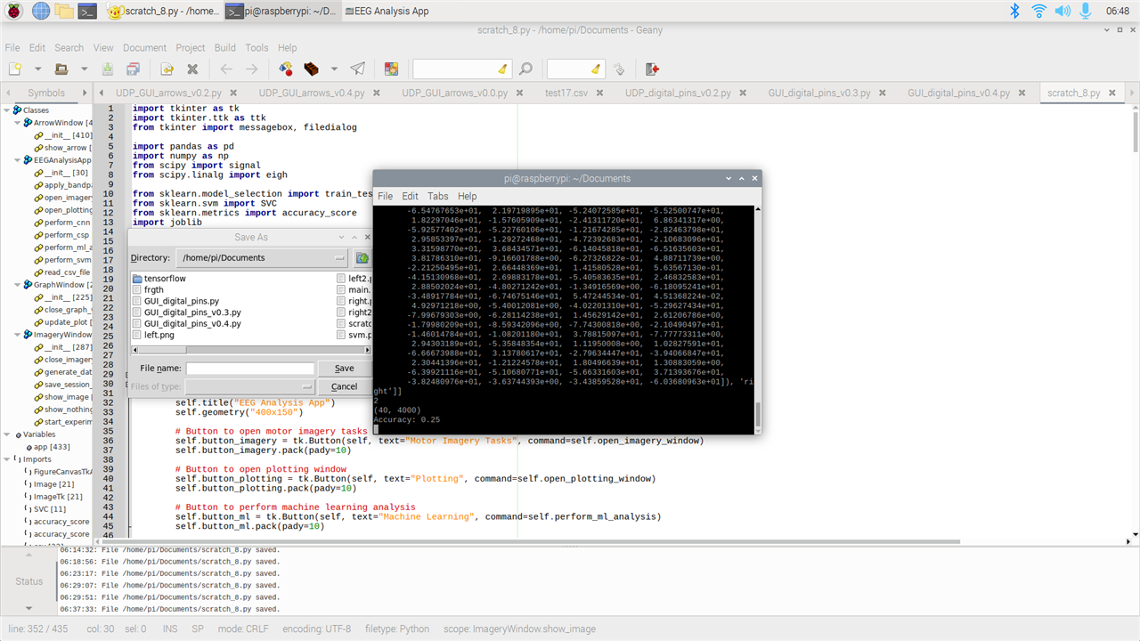

  • Machine Learning: you can read the csv file that it was generated and perform basic feature extraction (filtering data from 8 to 30Hz) and some signal processing (I used common spatial pattern since it is a common filtering algorithm for this task). Finally, it uses linear SVM to classify the data, print the accuracy and save the model. On windows, I managed to run also CNN layers but I am having troubles installing tensorflow on the Raspberry Pi4. If somebody knows some easy solution, please let me know. I managed to install everything else like pandas, sklearn, numpy, etc.
This is getting exciting because now I am building a full GUI on Python that everybody can easily use and learn. I am attaching below code and pictures of the GUI. I will later upload the code on my github so that everybody can contribute on this GUI. The goal of this GUI is that so everybody can use a Python GUI that runs on everything without problems and can do neuroscience projects/experiments. This will open the doors of neuroscience to literally everybody.

    def perform_svm(self, csp_data, labels):
        csp_data = np.array(csp_data)
        csp_data = np.reshape(csp_data, (csp_data.shape[0], csp_data.shape[1] * csp_data.shape[2]))
        # Reshape data_array if it has 3 dimensions
        print(csp_data.ndim)
        print(csp_data.shape)
        if csp_data.ndim == 3:
            csp_data = csp_data.reshape(csp_data.shape[0], -1)
        # Split the data into training and testing sets
        X_train, X_test, y_train, y_test = train_test_split(csp_data, labels, test_size=0.2, random_state=42)
        # Create and fit the SVM model
        svm_model = SVC()
        svm_model.fit(X_train, y_train)
        # Make predictions on the test set
        y_pred = svm_model.predict(X_test)
        # Calculate and print the accuracy
        accuracy = accuracy_score(y_test, y_pred)
        print("Accuracy:", accuracy)
        root = tk.Tk()
        root.withdraw()
        file_path = filedialog.asksaveasfilename(defaultextension=".pkl")
        if file_path:
            joblib.dump(svm_model, file_path)
            print("Model saved successfully.")
        else:
            print("Model not saved.")

class GraphWindow(tk.Toplevel):
    def __init__(self, main_window):
        super().__init__(main_window)
        self.title("Graph Window")
        self.protocol("WM_DELETE_WINDOW", self.close_graph_window)
        # Generate random initial data for 8 channels
        self.data = np.random.uniform(-70, 40, (8, 160))
        # Set the figure size and subplots dimensions
        fig_width = 8
        fig_height = 16
        subplot_height = fig_height / 8
        # Create subplots for each channel
        self.fig, self.axes = plt.subplots(nrows=8, ncols=1, sharex=True, figsize=(fig_width, fig_height))
        # Create lines and titles for each channel
        self.lines = []
        self.titles = []
        for i, ax in enumerate(self.axes):
            line, = ax.plot(self.data[i])
            self.lines.append(line)
            title = ax.set_title(f"Channel {i+1}")
            self.titles.append(title)
        # Set the axis limits and labels
        self.axes[-1].set_xlabel("Time (s)")
        self.fig.tight_layout()
        # Create the canvas to display the figure
        self.canvas = FigureCanvasTkAgg(self.fig, master=self)
        self.canvas.draw()
        self.canvas.get_tk_widget().pack()
        # Create a timer to update the plot every 62.5 milliseconds (16Hz)
        self.timer = self.after(62, self.update_plot)
    def update_plot(self):
        # Generate new random data for the next time step
        new_data = np.random.uniform(-70, 40, (8, 1))
        self.data = np.hstack((self.data[:, 1:], new_data))
        # Update the lines with the new data and set titles
        for i, line, new_values, title in zip(range(8), self.lines, self.data, self.titles):
            line.set_ydata(new_values)
            title.set_text(f"Channel {i+1}")
        # Move the x-axis limits to show the last 10 seconds of data
        self.axes[-1].set_xlim(self.data.shape[1] - 160, self.data.shape[1])
        # Redraw the canvas
        self.canvas.draw()
        # Schedule the next update
    def close_graph_window(self):
        self.after_cancel(self.timer)  # Cancel the update timer
        self.destroy()  # Destroy the graph window
        self.master.deiconify()  # Show the main window
class ImageryWindow(tk.Toplevel):
        self.title("Motor Imagery Window")
        self.protocol("WM_DELETE_WINDOW", self.close_imagery_window)
        self.display_time = 0
