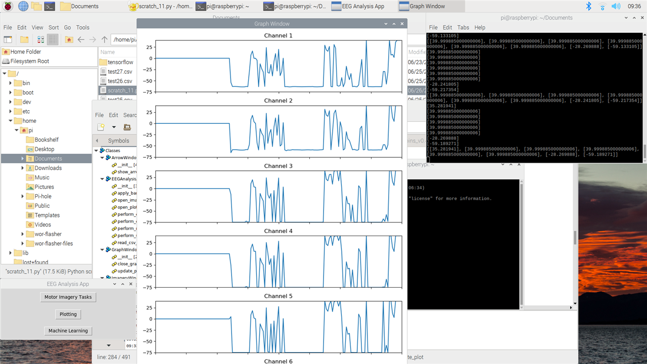

As mentioned on Post #1 and #2, I wanted to develop a device easy to use and powerful. The most common portable BCIs on the market connect to PC via Bluetooth using a Bluetooth dongle. I wanted to remove a dongle because I see it really annoying and can be an expensive component for the manufacturer to produce and for the user to lose. Also, I wanted to test Bluetooth capability of the ESP32. I had at home an Huzzah32 board. Previously, I transmitted data via UDP to the Raspberry Pi4 but I didn't like this method because I need to check for the Huzzah32's IP address every time it connects. I want to do something more automatic. This device should be used for every day's purposes so once it is set up the device should just be plug-in and play.
Connecting via Bluetooth
This project is my first time working on a board with Bluetooth and WiFi. I enjoyed this new challenge even though I might have done some stupid mistakes. It was a little bit tricky connecting via Bluetooth because when I use to connect the Huzzah32 with the Raspberry Pi4 from the Bluetooth panel, it would connect but saying there is no connection because there is no service. That is actually fine. I just need to connect once via Bluetooth the Raspberry Pi4 and the Huzzah32. Then, on the Raspberry Pi4 I need to run the following line on a terminal to get the MAC address of the Huzzah32.
hcitool scan
The Huzzah32 needs to be on and run the code below. I don't like the fact that it is not automated the detection of the MAC address. I would like to hear some suggestions from the community if you have a better way. At least, I just need to get the MAC address once and then it is just plug-in and play. Below you can find the code for the Huzzah32 and the Raspberry Pi4.

import tkinter as tk
import tkinter.ttk as ttk
from tkinter import messagebox, filedialog
import pandas as pd
import numpy as np
from scipy import signal
from scipy.linalg import eigh
from sklearn.model_selection import train_test_split
from sklearn.svm import SVC
from sklearn.metrics import accuracy_score
import joblib
#from tensorflow.keras.models import Sequential
#from tensorflow.keras.layers import Conv2D, MaxPooling2D, Flatten, Dense
#from tensorflow.keras.utils import to_categorical
from PIL import Image, ImageTk
import csv
import numpy as np
import matplotlib.pyplot as plt
from matplotlib.backends.backend_tkagg import FigureCanvasTkAgg
import random
import bluetooth
import time
target_address = "A8:03:2A:EB:03:16"
port = 1
class EEGAnalysisApp(tk.Tk):

class GraphWindow(tk.Toplevel):
    def __init__(self, main_window):
        super().__init__(main_window)
        self.title("Graph Window")
        self.protocol("WM_DELETE_WINDOW", self.close_graph_window)
        # Generate random initial data for 8 channels
        self.data = np.random.uniform(0, 0, (8, 160))
        self.sock = bluetooth.BluetoothSocket(bluetooth.RFCOMM)
        self.sock.connect((target_address, port))
        self.num_pins = 8;
        self.matrix = [[0] * self.num_pins]
        self.values = []
        # Set the figure size and subplots dimensions
        fig_width = 8
        fig_height = 16
        subplot_height = fig_height / 8
        # Create subplots for each channel
        self.fig, self.axes = plt.subplots(nrows=8, ncols=1, sharex=True, figsize=(fig_width, fig_height))
        for ax in self.axes:
                ax.set_ylim(-75, 40)
        # Create lines and titles for each channel
        self.lines = []
        self.titles = []
        for i, ax in enumerate(self.axes):
            line, = ax.plot(self.data[i])
            self.lines.append(line)
            title = ax.set_title(f"Channel {i+1}")
            self.titles.append(title)
        # Set the axis limits and labels
        self.axes[-1].set_xlabel("Time (s)")
        self.fig.tight_layout()
        # Create the canvas to display the figure
        self.canvas = FigureCanvasTkAgg(self.fig, master=self)
        self.canvas.draw()
        self.canvas.get_tk_widget().pack()
        # Create a timer to update the plot every 62.5 milliseconds (16Hz)
        self.timer = self.after(62, self.update_plot)
    def update_plot(self):
        data = self.sock.recv(1024)
        #print(data)
        if len(data) == self.num_pins * 4:
                for i in range(0, len(data), 4):

I made sure to use only pins connected to the 12bit ADC on the Huzzah32 as described in the pinouts below.
Plotting data on the GUI
As I mentioned on Post #5, I finished the GUI but I was generating random values. This time I was streaming the values to the GUI. The real time plotting was pretty straightforward. It was tricky on the motor imagery tasks since I had to rewrite some functions completely including the function to save the data into csv files. Now, all the GUI functions work and it is possible to start doing neuroscience projects with the GUI and the boards. You can see below the real time plotting of the data.
For now, I initialized the data with zeros. The analog value from the 12 bit ADC of the Huzzah32 gets converted from 0-4095 to (-75)-40 similar to the potential of a neuron. This explains why you see data going from 0 to -75 immediately. I initialized data at 0 and then when data is transmitted (so a value of 0 is transmitted) the plot goes to -75. The spikes are me touching the pins.
The data gets appended from the far right of the plot and moves to left. I want to change the plotting. So the plots start with zero data and it gets appended to the left and then moves to the right. When it reaches the far right of the plot, the entire plot should move to the right to include the new data (so the far left side should disappear when the plot is full and gets new data.
As for now I am plotting data that is being sent every second. I tried sending data at 16kHz and I can read it on the Raspberry Pi4 but I am getting some errors. I need to adjust the code so it automatically fits the transmission of data otherwise I will have packets too big with a higher frequency. End of the line, sending 16kHz of data is possible and this feature can unlock novel BCI experiments for portable devices since nowadays most of the devices limited themselves to only 250Hz.
Conclusion
This is the end of this project. I successfully managed to stream data from an ESP32 to a Raspberry Pi4 and created a GUI to conduct neuroscience projects. For now, the GUI has everything you need for basic neuroscience projects like plotting data in real time, save data in a csv file, and perform data cleaning, feature extraction and Machine Learning. The GUI needs a better looking design, different neuroscience experiments like P300 or SSVEP (they are paradigms commonly used for portable BCIs), and live testing of the Machine Learning model (so the GUI should read the data in real time and try to understand if the user is thinking left or right arrow). Maybe I will try to do it with the time remaining.This new GUI is built in Python in comparison to other popular GUI like OpenVibe so it can easily run on any device and it is easy to read and edit. On my summary post, I will share the link for the Github repository.
On the other end, I fabricated and tested hydrogel electrodes. On Post #4, I showed making hydrogel and on Post #5 I showed me testing them. The resistance is constant in all the hydrogel electrodes so it is a very stable formula. I am still having some issues with spilling so I didn't get the shapes I was looking for. I ordered magnets so that each layer of the stamps don't move and stay connected but this will be next week. These electrodes are really promising since they have a better signal to noise ratio than the golden standard silver electrodes, they don't require the application of gel for conductivity, they don't require to wear a cap to place them, they can be used multiple times with very small changes in signal to noise ration, and they are fairly cheap to produce (I have estimated the cost of materials to be 0.08 euros per electrode of size 15mm of diameter compared to the 33 euros for 1 silver electrode). I have attached below the cost of the material in bulk (left paper) and then calculated in ratio how much I need roughly for 4 electrodes (right paper).
The available portable BCI devices can be expensive and hard to use especially for people with no experience and training. More advanced electroencephalography can even cost tens or hundreds of thousands of dollars. This project shows it is possible to conduct neuroscience experiments and to build modern portable BCI devices while still having high performances and make it accessible to everybody.
